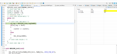

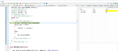

‎2025-06-21 5:22 AM
I made some adjustments to my code, and now I can see certain values. However, when I attempted to read the register value, it changed every time. I did not understand which part was problematic. This is my latest code. As far as I understand, the timing of the SPI communication between ADS1299 is critical. Is there any suggestion for fixing this misreading? According to the datasheet, when the reset operation finishes, I have to see the 0x3E value in the register.

uint8_t id_reg = 0;
uint8_t counter = 0;
/* Infinite loop */
/* USER CODE BEGIN WHILE */
while (1)
/* USER CODE END WHILE */
id_reg = ADS1299_read_reg(0x00);
if(id_reg == 0x3E)
counter += counter;
else
HAL_Delay(2000);
