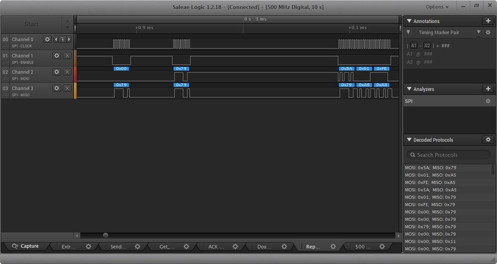

I am trying to use the SPI bootloader on a Nucleo F446ZE board and have problems when issuing commands. The symptom is that every other command is not acknowledge and every other works fine. Trying for instance the GET_VERSION command gives the following:
MOSI MISO
0x5A 0xA5
0x01 0xA5
0xFE 0xA5
The second time around it all works fine

Here are the signals from the communication. To the right is a table with the MOSI and MISO sequence. I agree that it seems something is out of sync. T

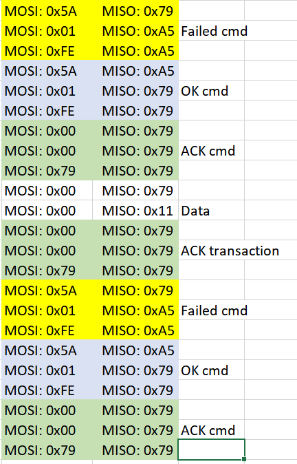

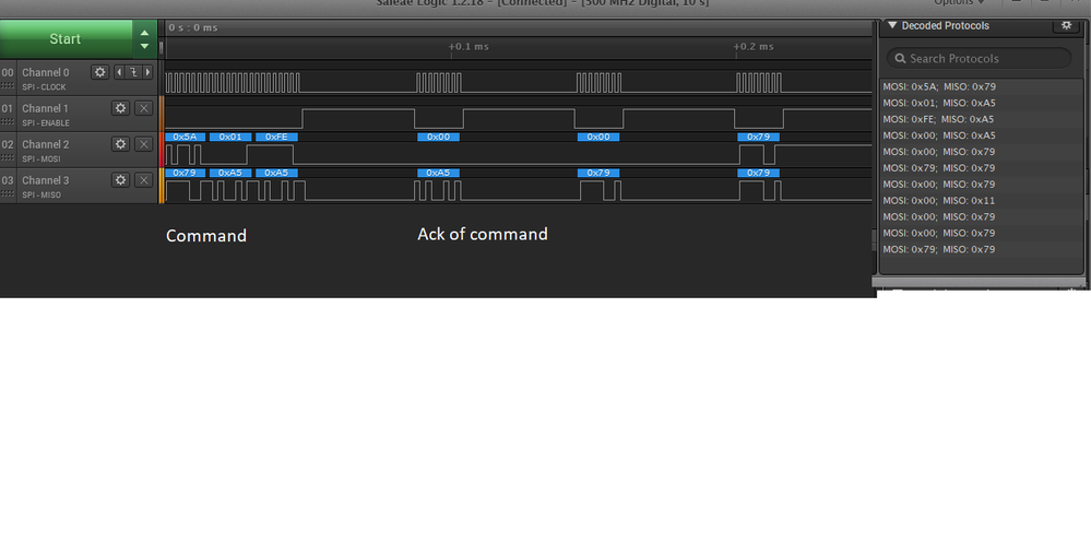

0690X000009jqpWQAQ.pngHere is the sequence with a working command. I cannot manage to get two commands in a row that succeed. I modified the code so that if the bootloader does not respond 0x79 on the third byte in the command I resend the command. The command then work according to the specification, with all responses correct. However sending the command again results in this exact same sequence with a failing response on the third byte. My feeling is that the statemachine in the bootloader somehow comes out of sync with my commands, but cannot figure out why or where.

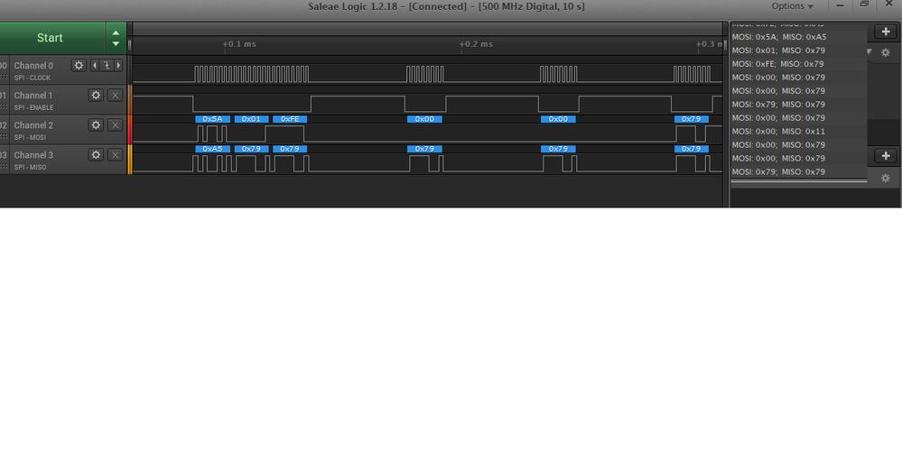

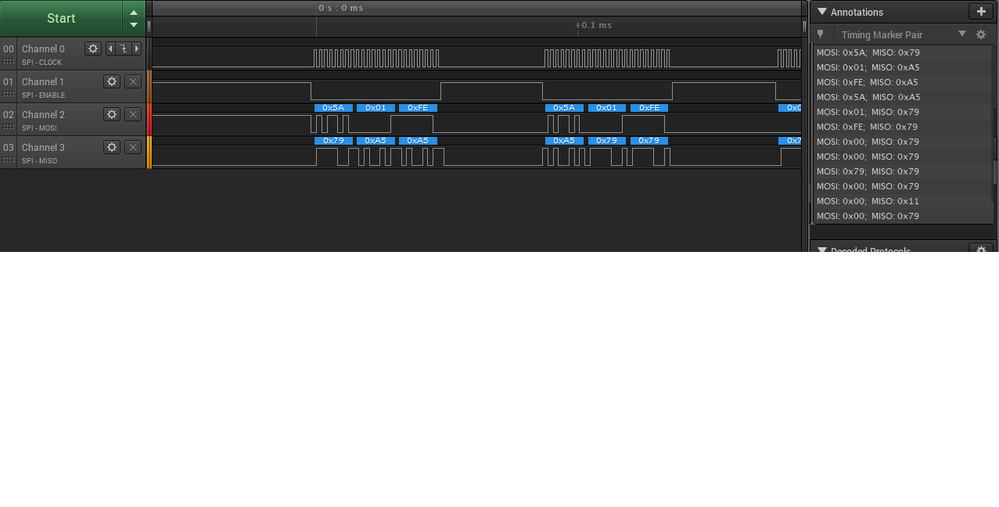

There is absolutely nothing going on. At least nothing that shows up on the logic analyzer. I have run commands back to back (see image and table with communication data), and get the same behavior every time. I have also tried do the ack procedure within the same chip select with no difference, and I have tried adding extra reads in different places but that really trashes the communication.
0xA5 isn't a NACK. The response to 0x5A, 0x01, 0xFE should be ignored. You search for an ACK/NACK afterwards. In fact, the slave is sending an ACK, but you're interpreting it incorrectly. The slave/master finally sync back up when you send a 0x79, which is how the ACK/NACK terminates.
