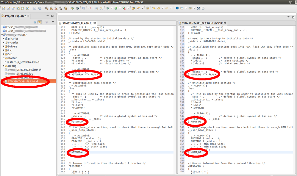

‌ found that we need to use RAM_D1 and not DTCMRAM of the memory area. This is not made by default when we use STM32CubeMx to set SPI and DMA together. Hello, I am working on a full duplex SPI communication through DMA using STM32H7. So, I have bought 2 NUCLEO-H743ZI, one to be the master, the other to be the slave. I have downloaded, built and flashed SPI_FullDuplex_ComDMA example via TrueStudio. As there is no ''TrueStudio format'' example, I have generated the project with STM32CubeMx and replace Inc and Src generated files with SPI_FullDuplex_ComDMAfiles. And tadada! ... It is not working correctly....... Only a few bytes are sent and Rxbuffer is never filled.

Best answer by
Posted on March 14, 2018 at 18:03
I've just found the difference between the HAL Nucelo example projects and the CubeMX generated projects.The problem for the DMA transfer error is that we use the false RAM!!
I have changed the settings in MDK-ARM from
IRAM1 (default setting from CubeMX) to
IRAM2 (same is in the example projects) and now the SPI DMA transfer runs without error.
I've found out, that with this memory address
IRAM1 is the
DTCM-RAM and
IRAM2 is the
AXI SRAM D1.
enjolras.g
please check also in your project with TrueStudio and if it works, please share also the correct settings.
