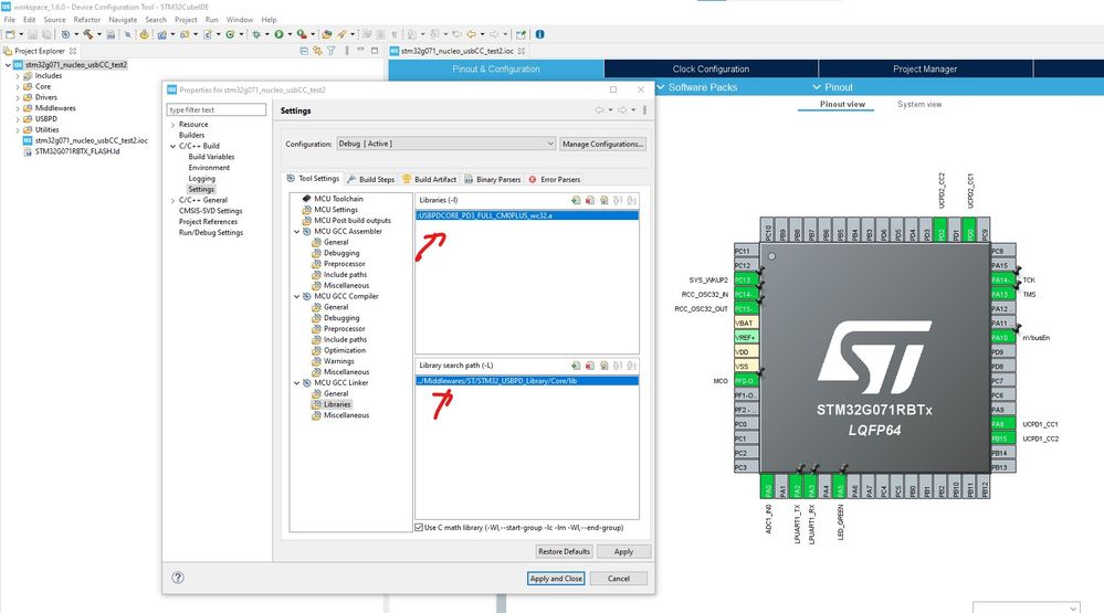

Regenerating a UCPD project in CubeIDE 1.6 deletes the library file from the linker settings in the project configuration.
  • March 31, 2021
  • 5 replies
  • 1744 views
This thread is a new problem discovered while investigating a different USB-PD issue in another thread. @Yohann M.​ recommended that I create a new thread for this issue. Here is the link to the other thread: https://community.st.com/s/feed/0D53W00000e3gI6SAI
I've set up a basic project to run the USB-PD middleware in CubeIDE 1.6 on the Nucleo-G071RB dev board. Basically, turn on UCPD 1 and 2, enable freeRTOS, serial port, USBPD middleware, tracer EMB, and GUI interface. After generating the project, the library :USBPDCORE_PD3_FULL_CM0PLUS_wc32.a is missing from the linker settings in the project configuration. If I regenerate the project again, after adding the missing file, the setting is erased so that I have to add the missing file every time.
If I make a copy of the IOC file in a new directory, open it in standalone CubeMX 6.2.0, and generate the project, the library file is present in the linker settings.
I tried starting a new clean project with more or less the same settings in CubeIDE and got the same error.
The weird thing is, this error only started sometime last week. Before that, I was able to generate the project without incident.
I have attached the IOC file.

Works like a charm on my side if IDE 1.6.0.
I'm relying on "File > New STM32 project from an existing STM32CubeMX configuration file" to create a project from your shared file. Here is result: .a library is well set.
If adding some IP setup and asking for project udate such setup is preserved.

Yeah, I'm pretty sure my machine just has gremlins or something. As it stands, it's easy to fix, but annoying to have to add the file back in every time I regenerate.
