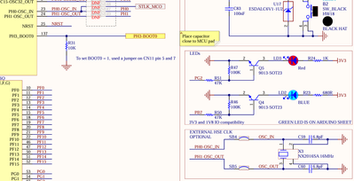

Here are some detail pictures of my board. I think these are the correct default settings. (I got the board from a customer. I don't think they changed anything to the jumpers.)

Never mind. Found the fix.
The setting for HSE must be set to 'Crystel/Ceramic Resonator', just like with the LSE.
Now I can debug my project.
