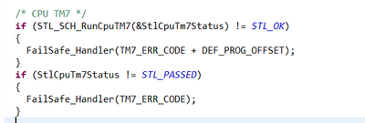

Hi team,
We have selected Trust zone MCU STM32U585ZIT6Q (U5 series) for our project.
We are using with Trust zone enable in our project with AZURE RTOS.
1: without Thread x STL Lib working .
2: with Thread x STL lib  failed for CPU TM7 function . PSP ,MSP
how to activate privilleged mode in CPU TM7.
thank you

Petr Sladecek
I'm not sure if your request is tied somehow with the next one, please follow my reply there, too:
X-CUBE-CLASSB-U5(STL) issue(Hardfault) of TM7 test... - STMicroelectronics Community
Anyway, pls verify if the TM7 test is executed from secured region at thread privilege mode and mainly if its execution can't be interrupted.
Best regards,
Petr

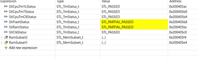

Thank for your response.
Seetha643
Now class b running with threadx suessfully.
Why flash and RAM test status Partial passed?
My question STL_PARTIAL_PASSED status accept in certificate.
thank you.
Petr Sladecek
status of your test is fully dependent on definitions of subsets at user structures and configured atomic steps. You can perform all the subsets at single run or per parts. Please study associated UG.
Best regards,
Petr
