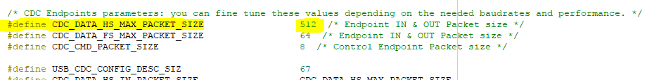

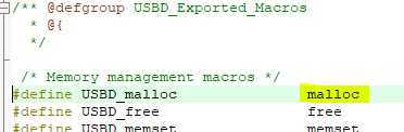

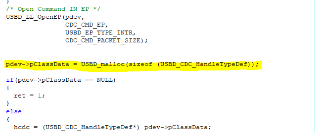

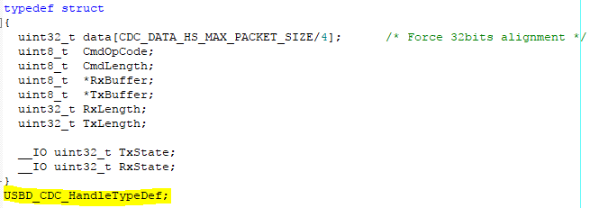

‎2017-09-27 1:48 AM
Inside USBD_CDC_Init(..) function there is a malloc function which allocates about 540 Bytes memory on the Heap.
This was not taken into account from CubeMX when code generated .
So , at least you must define the Heap size taking into account theese extra Bytes, to have the USB CDC port working.
the malloc function def.
the allocation
the typedef of handle
and the size of max packet size.
It will help the comunity to solve your problem if you post your IOC file and other relative code here.
