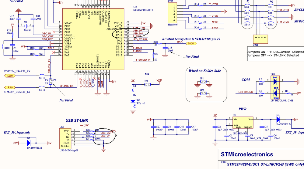

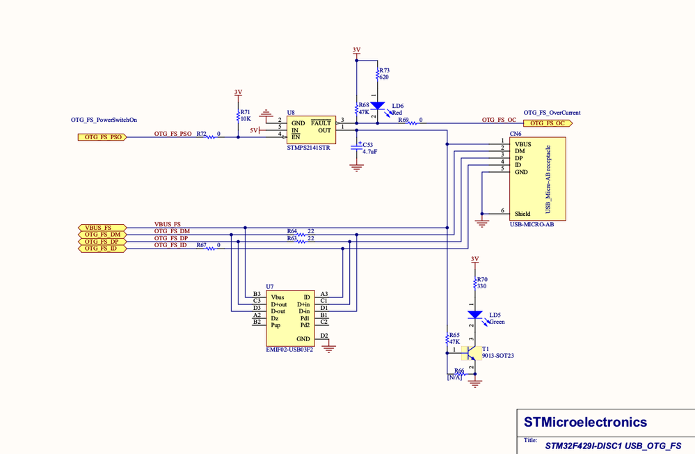

I tried running USB CDC Virtual Com Port on F429 using USB_FS which according to boards user manual is connected to the microUSB (CN6), code I generated using CubeMx and result was I couldn't see Com port when I did ''dmesg'' on the terminal.
Then few days after struggling I flashed USB CDC Virtual Com Port project for USB_HS and Com port showed up in the list but then again when I tried to send a string (pClassData in the descriptor was NULL so transmit function returned fail) it didn't work, but this is not something I'm trying to discuss here.

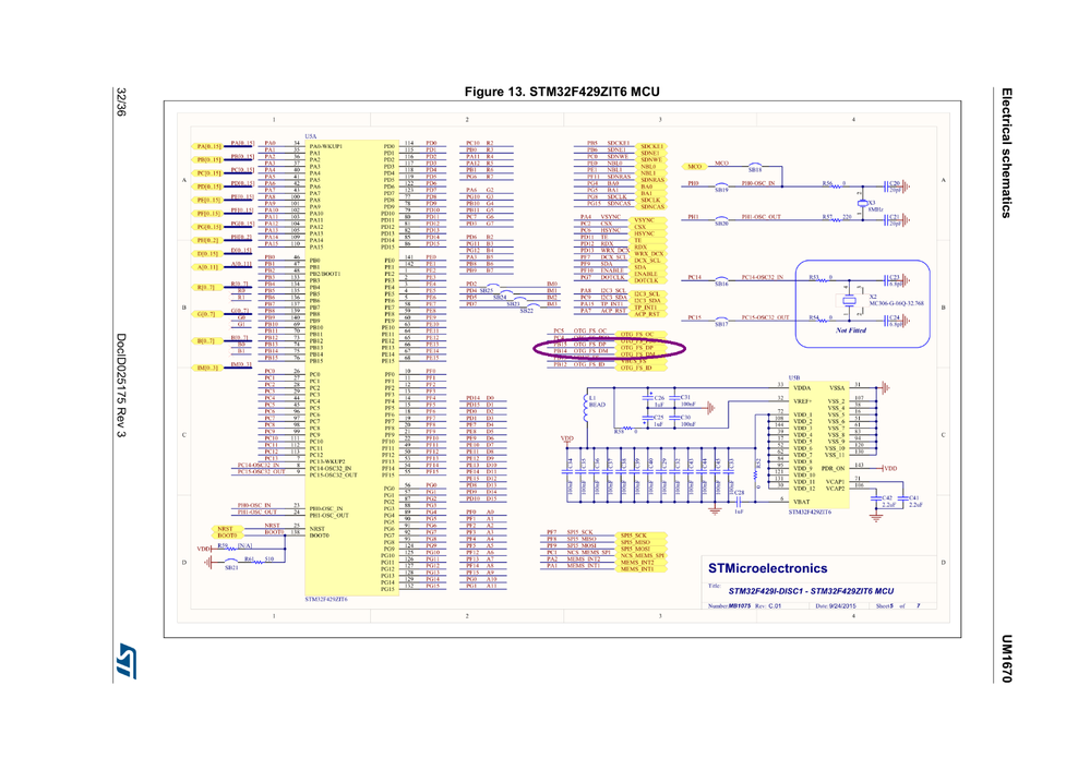

After this I further investigated about FS and
schematic shows USB_FS is what being also used by ST-Link.

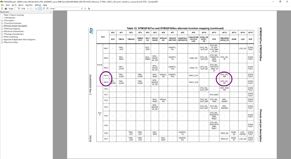

USB_FS Pins: PA11 and PA12
USB_HS Pins: PB14 and PB15
and attached are two snapshots from Board's user manual.

Your question and problems are not really clear to me. However two circles in the picture below belong to the STM32F103Cx of the Stlink and have nothing to do with OTG-FS of the STM32F4.
_LardDork _
December 19, 2017
Posted on December 19, 2017 at 13:56
Hi Bonnes,
Thanks for pointing that out, very stupid of me not have noticed that. And problem I'm facing is with STM32F429x Discovery board, microUSB connector CN6 is connected USB_FS not USB_HS as seen from the schematic. But when I flash the USB_CDC example for HS Virtual Com port shows up in devices but when same done for FS is doesn't, which is counter of what is shown in schematic.That brings me to conclusion that HS is connected to microUSB CN6.
~ Brian.

To get USB HS, all STM32 beside STM32F72 need a HS transceiver, as you can see on F46x and F76x discovery. Without the external transceiver, the port can only do FS. So get an example for your board (f42 disco) and not something else.

I'd say you are right:
i.e. the signals are mis-named in the F429-DISCO manual, they should be OTG_HS_xx instead of OTG_FS_xx.
Of course, they have to be renamed also on other schematics pages.
Chapter 6.7  USB OTG supported should mention, that OTG_HS is used but with the internal PHY, ie. in FS mode.
ST, when making changes, could you please modify also the pinout table (Tab.6) to the style this table is in the F407-DISCO now? Thanks.
