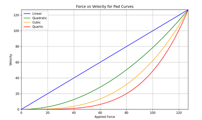

I am trying to implement a STM32 based pad assessment functionality, in which the applied force should be converted to the velocity based on user set polynomial degrees as in below image. I have implemented the code to calculate velocity based on ADC values and apply it to pad curve functionality. But I don't have any mechanical setup to measure the force applied so I can plot the Force vs Velocity curves. I would like to get some feedback on the implementation and need some idea on how to test the same.
FinalVelocity = ApplyPadCurve(user_velocity, usr_degree);
uint8_t ApplyPadCurve(uint8_t velocity, uint8_t degree)
uint8_t FinalscaledValue = scaledValue;
switch (degree)
case 1: // Curve deg 1 (Linear)
break;
case 2: // Curve deg 2 (Quadratic)
FinalscaledValue = pow(scaledValue, 2.0) / 100;
break;
case 3: // Curve deg 3 (Cubic)
FinalscaledValue = pow(scaledValue, 3.0) / pow(100, 2.0);
break;
case 4: // Curve deg 4 (Quartic)
FinalscaledValue = pow(scaledValue, 4.0) / pow(100, 3.0);
break;
default:
break;
return FinalscaledValue;

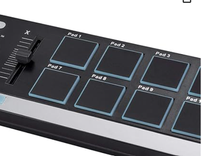

‎2024-10-17 9:08 AM - edited ‎2024-10-17 9:09 AM
Hello Andrew Neil,
I’m referring to the velocity-sensitive pads used in MIDI instruments, as shown in the image below.
‎2024-10-17 9:20 AM
So where did you get that curve from?
Are you creating a new device, or just "hacking" an existing product?
If it's an existing product, can't you just just look at the MIDI output it gives?
@Rider wrote:I don't have any mechanical setup to measure the force applied
Weight is a force ...
But isn't what you're really interested in just the velocity? The actual force is immaterial, surely?
You could measure velocity with a light-gate.
Or drop a known weight from a known height - so velocity can be calculated ...
‎2024-10-17 11:55 PM
Actually, I am working on requirement to develop a velostat based stand alone pressure sensitive pads. The requirement is that pad should work in 4 modes based on the curves set by user. I have the hardware setup and code, but I don't know how I can validate this. Since, I don't have any external setup to measure the force applied. As of now, I am plotting the obtained ADC values and calculated velocity data. I don't know whether this is a correct approach. I need suggestions on how I can validate this functionality.
‎2024-10-18 12:48 AM - edited ‎2024-10-18 12:51 AM
@Rider wrote:I am working on requirement to develop a velostat based stand alone pressure sensitive pads.
Still unclear on what the actual purpose of this is.
What, exactly, is the required output of this system?
Is this a school/college assignment? If so, you should be going to your teacher/supervisor for advice.
It really has nothing to do with STM32 as such.
@Rider wrote:I don't have any external setup to measure the force applied. .
Again, weight is a force. Very easy to apply a controlled static weight, or drop a known weight from a known height.
