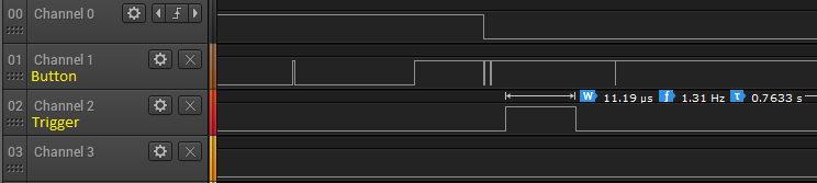

I'm writing library for HC-SR-4 (Ranging Module). To start measurement I have to:
1) send 10 us high signal to TRIGGER and than
2) measure duration of high signal on ECHO
To get 10 us duration I use one of basic timers with enabled interruption.
When I try to send signal TRIGGER for the first time I get strange early interruption. On the picture, you can see measurement performed by logical analyzer after pressing the button (which also sets high level on TRIGGER and starts timer):

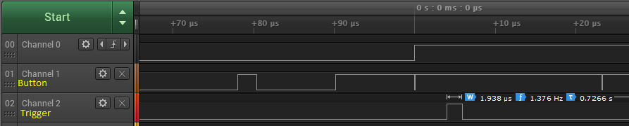

Next press:
I can ignore this first interruption since after it timer works correctly. But to make library work I use two timers instead of one. For now it is not so bad but it is improper approach and I would like to understand why this happens.

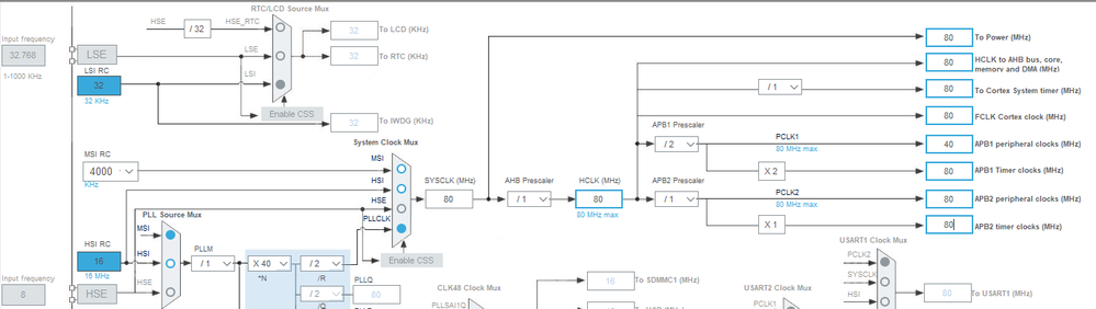

Answering Clive:
Timer settings
/* TIM7 init function */
void MX_TIM7_Init(void)
TIM_MasterConfigTypeDef sMasterConfig = {0};
htim7.Instance = TIM7;
htim7.Init.Prescaler = 79;
htim7.Init.CounterMode = TIM_COUNTERMODE_UP;
htim7.Init.Period = 9;
htim7.Init.AutoReloadPreload = TIM_AUTORELOAD_PRELOAD_DISABLE;
if (HAL_TIM_Base_Init(&htim7) != HAL_OK)
Error_Handler();
sMasterConfig.MasterOutputTrigger = TIM_TRGO_UPDATE;
sMasterConfig.MasterSlaveMode = TIM_MASTERSLAVEMODE_DISABLE;
if (HAL_TIMEx_MasterConfigSynchronization(&htim7, &sMasterConfig) != HAL_OK)
Error_Handler();

Clock configuration

‎2018-12-04 1:08 PM
Perhaps show how the TIM is configured, and where the interrupts are occuring on your plots. Not really clear to me what's what. CH2/TRIGGER presumably the ECHO you want to measure, but what are you seeing on the STM32 side?
