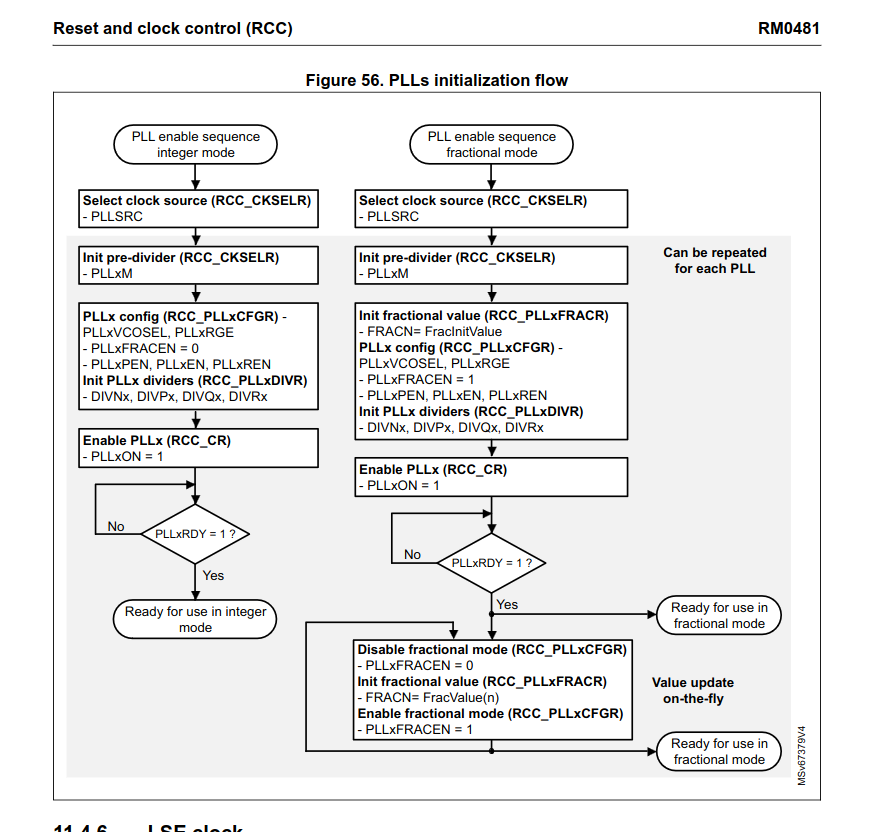

Hey all,
i need to use the Rust Programming Language. Now i want to enable the PLL to increase the system srequency.
I'm using the "stm32h5" crate (https://crates.io/crates/stm32h5).
let dp = stm32h563::Peripherals::take().unwrap(); // Setup handler for device peripherals
 let rcc = dp.RCC;
 dp.FLASH.acr().write(|w| unsafe {
 w.latency().bits(5);
 w.prften().set_bit()
 dp.PWR.voscr().write(|w| w.vos().bits(0b11)); //VOS scale 1
 while dp.PWR.vossr().read().vosrdy().bit() != true {}
 dp.ICACHE.cr().write(|w| w.en().set_bit());
 rcc.cr().write(|w| w.hsebyp().set_bit());
 rcc.cr().write(|w| w.hseon().set_bit()); //Enable High speed external clock 8 MHz
 while rcc.cr().read().hserdy().bit_is_clear() {}
 rcc.cr().write(|w| w.hseext().set_bit());
 //PLL1
 rcc.cr().write(|w| w.pll1on().clear_bit());
 while rcc.cr().read().pll1rdy().bit_is_set() {}
 rcc.pll1cfgr().write(|w| w.pll1src().bits(0b11)); //HSI as PLL1 source
 rcc.pll1cfgr().write(|w| unsafe { w.pll1m().bits(4) }); //'16' for HSI
 rcc.pll1divr()
 .write(|w| unsafe { w.pll1n().bits(249).pll1p().bits(1).pll1q().bits(1) }); //250 MHz
 rcc.pll1fracr().write(|w| w.pll1fracn().bits(0));
 rcc.pll1cfgr().write(|w| w.pll1fracen().set_bit());
 rcc.pll1cfgr().write(|w| w.pll1rge().bits(0b01)); //input frequency range 2 MHz to 4 MHz
 rcc.pll1cfgr().write(|w| w.pll1vcosel().clear_bit()); //output frequency wide VCO range
 rcc.pll1cfgr().write(|w| w.pll1pen().set_bit());
 rcc.pll1cfgr().write(|w| w.pll1qen().set_bit());
 rcc.cr().write(|w| w.pll1on().set_bit());
 while rcc.cr().read().pll1rdy().bit_is_clear() {} //Stuck here
Does anybody know, what i'm doing wrong? Coudn't find any solutions so far.
Thanks

The command in line 23 is wrong. The HSE is the source, but the bits are right
July 2, 2024
Why are you enabling the fractional mode, when you program the integer mode (RCC_PLL1DIVR) from the PLL?
The initialization flow according the TRM:

Hey Krotti42, thanks for your message.
I need the PLL for the FDCAN peripheral. For that i found an example here https://github.com/STMicroelectronics/STM32CubeH5/tree/main/Projects/NUCLEO-H563ZI/Examples/FDCAN

And here they used the fractional value = 0 (as you can see in line 49). So i thought i could give it a try, but still won't work. Now I deleted this 2 lines out of my code, but noting changed.
