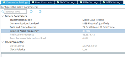

The driver instructions don't mention that some configuration is needed in CubeMX, although the I2S2_init function unhelpfully says, "This function assumes that the I2S input clock (through PLL_R in Devices RevA/Z and throughd edicated PLLI2S_R in Devices RevB/Y) is already configured and ready to be used."
I copied the settings seen in this instructional video. That didn't work, but it did at least cause the callback functions to start being called... once each, then never again, with the hi2s2 state staying as HAL_I2S_STATE_READY.
I2S2 settings:
