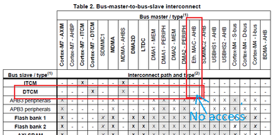

Well, trying to move the LwIP heap memory to a larger memory location I experienced a n unexpected issue:
When I locate the heap in the DTCMRAM of the M7 core, communication will no more work at all(no ping, no tcp connection...).
Locating it in D1 (AXI RAM) or D3 RAM all work as expected.
I checked also the MPU configurations ad all seems correct, it seems that in DTCMRAM there is a different behavior.
Just for my comprehension, there is something wrong in locating such heap into the DTCMRAM?

I'm not an ETH expert but seems the heap is used by one of DMA1/DMA2 masters that does not have access to DTCM  RAM.
From RM0399 reference manual:
Same as: https://community.st.com/t5/stm32cubeide-mcus/adc-with-dma-in-scan-mode-is-not-resulting-in-call-to-hal-adc/m-p/660253
EDIT: I forgot to mention the ETH master which also doesn’t have access to the DTCM.

Intresting!
Just a clarification: in my application project I don't settled up any DMA usage for the ethernet commnunication.
Could be that LwIP package is using DMA in a "hidden" way?
Several masters such as DMA1, DMA2, ETH (used in your case) etc .. don't have access to DTCM RAM. Look at the table 2 in the RM0399 I've already shared.
I've already edited my previous post.

I confirm SofLit's post, the ETH DMA (neither any other DMA :( ) cannot access DTCM.
I had to place it in D1 AXI SRAM (H7xx).

A small message to highlight the fact that the STMCubeMX generates an ethernetif.c file containing the following attributes:
RxDecripSection
TxDecripSection
This can lead into a lot of typo errors in the linker script.
You will often find on the Internet example with:
RxDescripSection
TxDescripSection
With the correct configuration, it is possible to place the app (stack, data, bss) on DTCMRAM and use the ETH with descriptor, data packet placed on RAM_D2.
