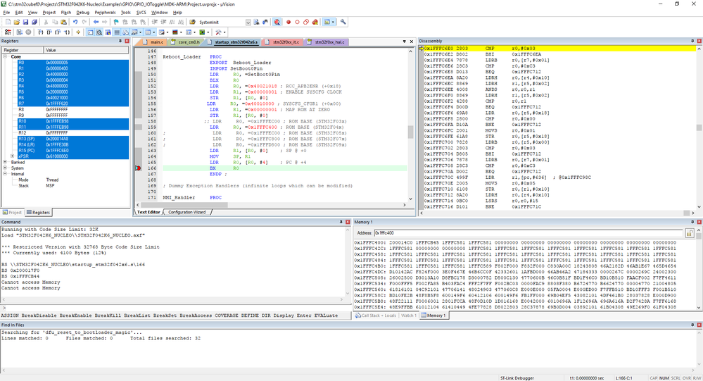

ENDP ,Snapshot when the code is jumped to system memory bootloader. Notice the jump to the code location 0x1FFFCB45 as per the memory window showing the value at the reset vector address.

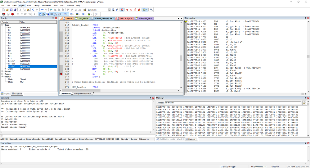

Allowed the code to run for some time. Notice the change in PC register shown in the registers window
