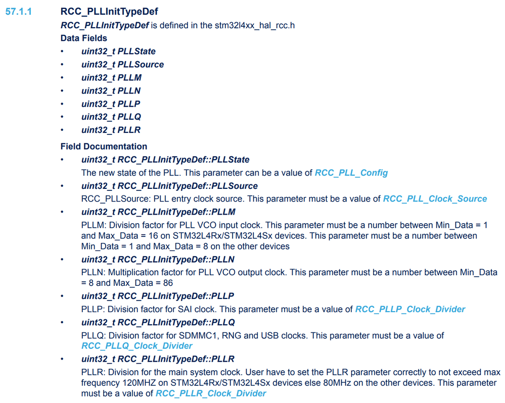

Is UM1884 (STM32L4/L4+ HAL and low-layer drivers UM) description for RCC_PLLInitTypeDef inconsistent with header file 'stm32l4xx_hal_rcc.h' generated by STM32CUBEMX with respect to PLLP, PLLR parameter definitions?
  • September 17, 2020
  • 1 reply
  • 1259 views
The structure definition for RCC_PLLInitTypeDef in the header file 'stm32l4xx_hal_rcc.h', generated by STM32CUBEMX, is inconsistent with the RCC_PLLInitTypeDef struct description in the STM32L4/L4+ HAL and low-layer drivers UM (UM1884 Rev8) page 821, specifically PLLP, PLLR parameters.

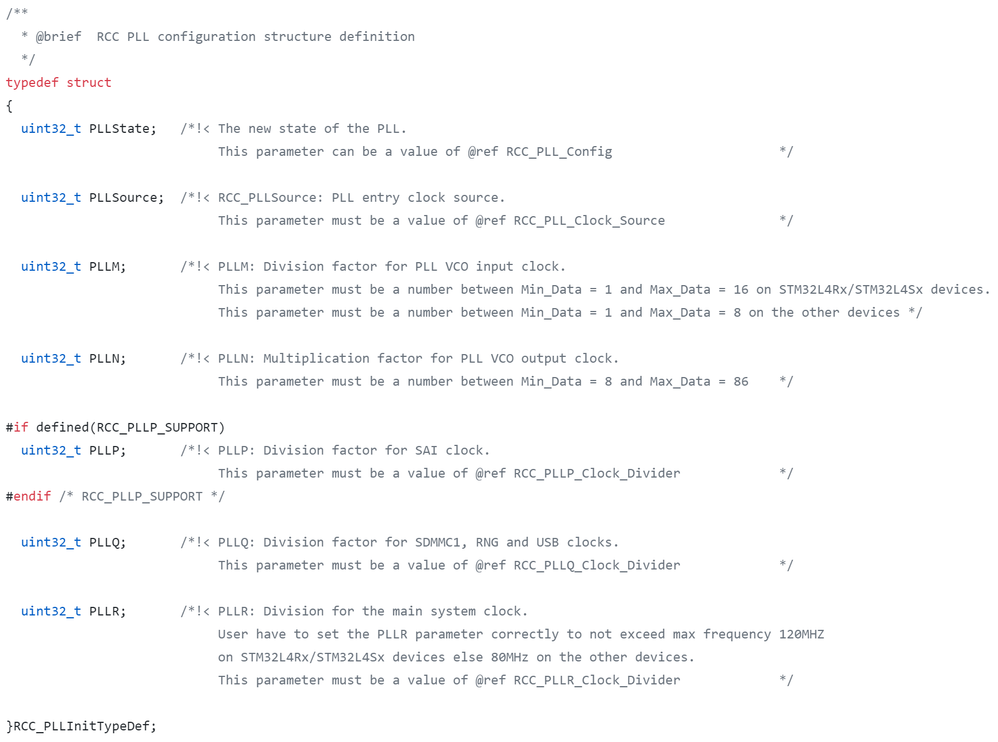

Compare that description with the RCC_PLLInitTypeDef in stm32l4xx_hal_rcc.h, generated by STM32CUBEMX for nucleo-l4r5zi_ board:
 typedef struct {
 #if defined(RCC_PLLP_SUPPORT)
  uint32_t PLLP;    /*!< PLLP: Division factor for SAI clock.
               This parameter must be a value of @ref RCC_PLLP_Clock_Divider       */
 #endif /* RCC_PLLP_SUPPORT */
  uint32_t PLLQ;    /*!< PLLQ: Division factor for SDMMC1, RNG and USB clocks.
               This parameter must be a value of @ref RCC_PLLQ_Clock_Divider       */
  uint32_t PLLR;    /*!< PLLR: Division for the main system clock.
               User have to set the PLLR parameter correctly to not exceed max frequency 120MHZ
               on STM32L4Rx/STM32L4Sx devices else 80MHz on the other devices.
               This parameter must be a value of @ref RCC_PLLR_Clock_Divider       */
 }RCC_PLLInitTypeDef;
Am I missing something?
1 reply
September 18, 2020
Looks consistent to me. PLLQ and PLLR are defined in both. What do you think is inconsistent about them?
If I were you I would throw away the user manual and consult the code directly. It's always going to be correct.
