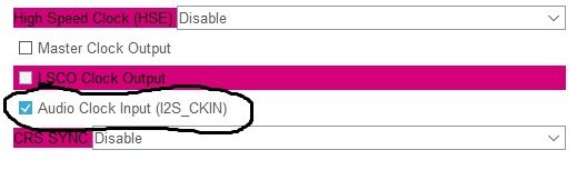

When I set up a fresh project for the STM32G431KB in STM32CubeIDE, let's say I want the SAI to be clocked by an external clock source.
So, in the prefs, I set Audio Clock Input (I2S_CKIN):

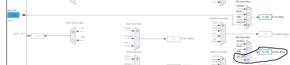

Then I set up my Clock Configuration:

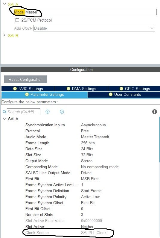

Now one would expect now when I go to the SAI configuration, that my clock would be shown correspondingly, well, my friend, you would be wrong:

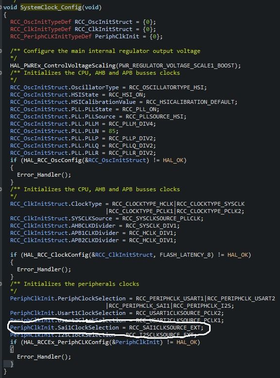

Note how "Clock Source" is listed incorrectly as "SAI PLL Clock", not only that, but let's look at the code-gen to see what's REALLY happening:0693W000001ccBvQAI.jpg
Well look at that, it's actually set correctly, but confusingly displayed incorrectly in the GUI.
