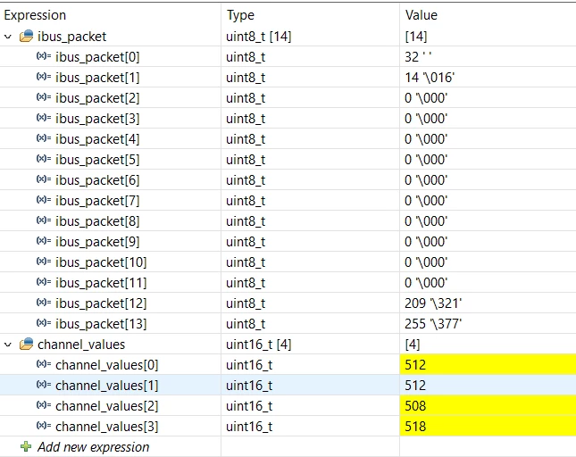

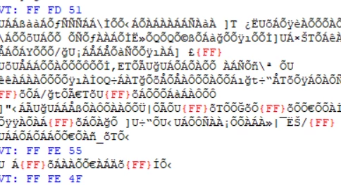

I want to transmit adc values to hercules while using ibus protocol.
  • March 4, 2025
  • 1537 views
Hi here is my code. I just started to learn stm32 codding and ı want to send analog signal I obtained with the help of ibus protocol. But hercules program has random letters.
I know what I did might be completely ridicilous but I wanted to try my luck.

Andrew Neil
March 4, 2025
Welcome to the forum.
Please read How to write your question to maximize your chances to find a solution; in particular, How to insert source code.
@juanjuan wrote:
I just started to learn stm32 coding and ı want to send analog signal I obtained with the help of ibus protocol. But hercules program has random letters.*/
It would be wiser to take things in smaller, simpler steps.
Start by just getting the basics working before moving on to more complex stuff - like ADCs and ibus protocol.
Two main reasons why you see "junk" characters on a terminal:
  1. The baud rate is wrong:
    https://learn.sparkfun.com/tutorials/serial-communication/all#:~:text=If%20all%20the%20receiving%20device%20sees%20on%20its%20receive%20line%20is%20garbage%2C%20check%20to%20make%20sure%20the%20baud%20rates%20match%20up
  2. Sending non-text data.
    If you send binary data, it will not give you readable text on a text terminal
March 5, 2025
