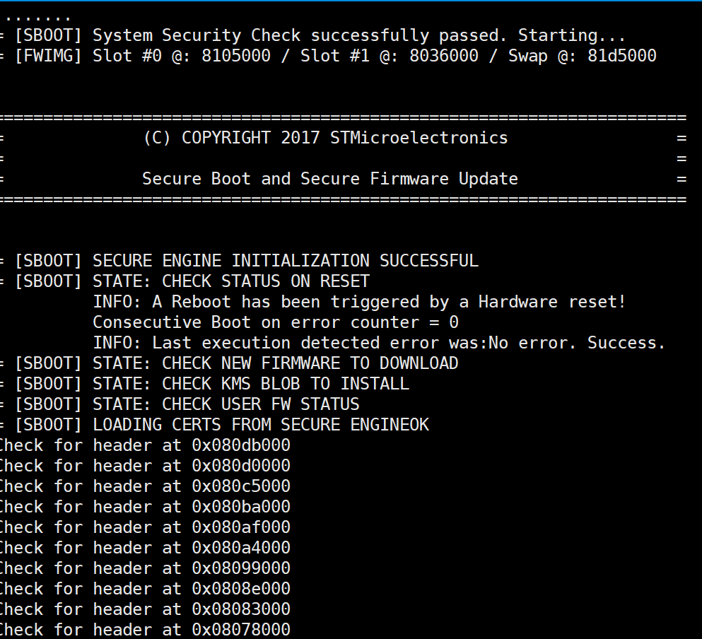

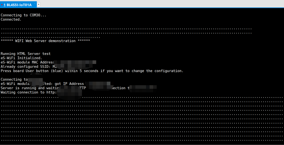

0693W00000Y7AP6QAN.pngpic1: web demo fw good
0693W00000Y7AMhQAN.pngpic: web demo fw broken
