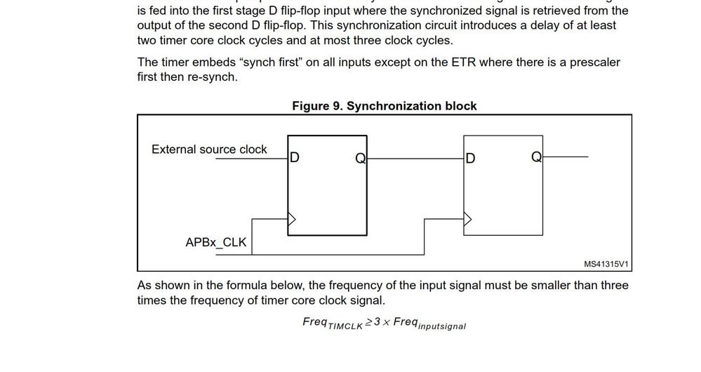

If it is a clock that used rather than APBx clock source, why it must be synchronized first?

You still have to access the TIM peripheral registers in the APB clock domain, so the clock edge that increments the counter is coherent with the APB clock, and you don't get phase issues, and setup/hold violations.
