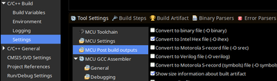

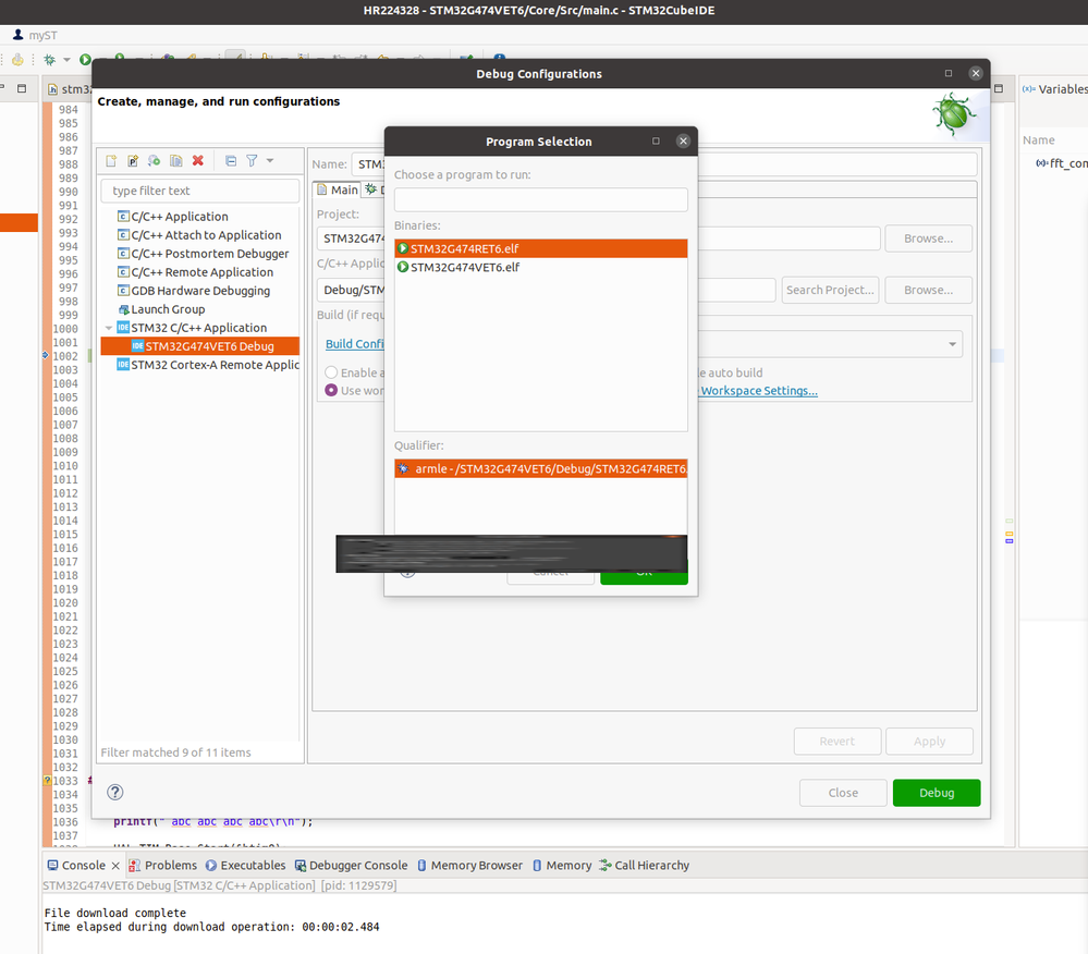

Exactly what I am trying to do. I have read in the binary modified it to contain a CRC32
and now want to read my modified hex file in, with the symbols coming from the
'elf' file. But the only file types I seem to be offered are elf and something called 'axf'.
I want to be able to use the hex file because that is what production get

me too. I know it used to read the hex file for the flash data and the lef file for the symbols. so you could debug the actual hex file that had , say, a CRC32 checksum in it.

Tools are available to convert from AXF or ELF to HEX; eg, objcopy
https://ftp.gnu.org/old-gnu/Manuals/binutils-2.12/html_node/binutils_5.html
https://stackoverflow.com/questions/19458031/how-to-create-a-executable-hex-from-elf-file-format
It used to offer hex images, but now it only seems to offer the elf file
IDE -> project -> properties ->
in debug -> hex file
AXF files are ELF files, they are usually coming from Keil / Realview

That's for INPUT to the DEBUGGER, you need options of OUTPUT from the LINKER
Could use OBJCOPY or FROMELF
