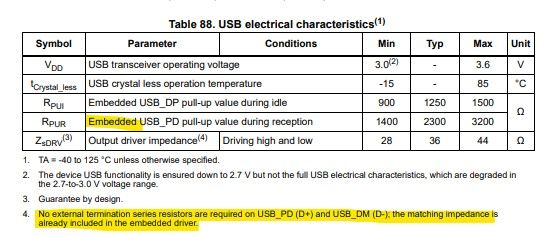

1) Pull up for DP
Back in the F1 boards I had to put a pull-up 1.5k resistor between DP and 3.3V, now it seems that the needed circuit is already provided inside the package. Si I can remove R1, R2 and R5. Is it correct or did I misunderstood it? What about the 2 cap (C13, C14)?

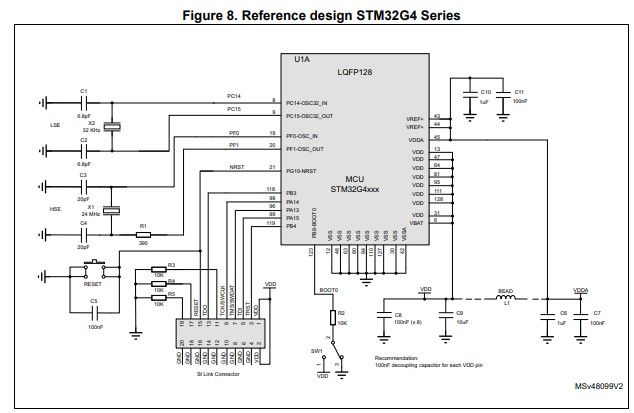

3) VREF pin usage
I can have this pin connected to VDDA or to an external source (plus 2 cap):
"If JP2 is closed then C10 and C11 doesn't have to be populated"
4) BOOT0 pin wiring
I think I should wire this pin to GND for normal operation and to 3.3V for uploading of new code. I think I would do it with a header-jumper but other suggestion (or correction) are welcomed

You can remove everything on that line. If you want additional ESD protection, put a dedicated chip on the data lines for that. Take a look at AN4879.
https://www.st.com/resource/en/application_note/dm00296349-usb-hardware-and-pcb-guidelines-using-stm32-mcus-stmicroelectronics.pdf
> 3) VREF pin usage
Typically this is directly connected to VDDA. Same notes as in (5) below.
> 4) BOOT0 pin wiring
If you're programming over SWD, you can hook this straight to GND. Only reason you need to pull it up is to enable the system bootloader.

> 1) Pull up for DP
I removed all the resistors on the DM/DP lines but I keept the two capacitors, should I remove also them?
> 3) VREF pin usage
I would do as you suggest and I will keep the JP2 closed, also this is the same as the reference design from STM
> 4) BOOT0 pin wiring
I would mainly use the bootloader so I would need to switch in a simple way the BOOT0 pin
