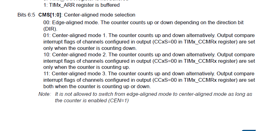

Has anyone else noticed a typo in stm32g4xx_ll_tim.h in the cube. TIM_CR1_CMS_0 is the center-down.
DAlbe.1375
#define LL_TIM_COUNTERMODE_CENTER_UP          TIM_CR1_CMS_0       /*!< The counter counts up and down alternatively. Output compare interrupt flags of output channels are set only when the counter is counting down. */
#define LL_TIM_COUNTERMODE_CENTER_DOWN        TIM_CR1_CMS_1       /*!<The counter counts up and down alternatively. Output compare interrupt flags of output channels are set only when the counter is counting up */

Hello @DAlbe.1375​ ,
You are right, I raised this issue internally for correction.
The mode are inverted and TIM_CR1_CMS_0 should be LL_TIM_COUNTERMODE_CENTER_DOWN.
0693W000000UCZwQAO.pngThank you for your highlight and contribution.

Imen.D
This issue is fixed in the STM32CubeG4 V1.3.0.
Thank you for your contribution to improve our products.
