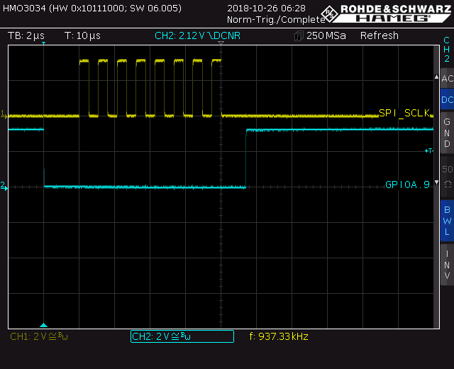

I've a problem with HAL_SPI_Transmit_IT() function as it blocks similar to HAL_SPI_Transmit.
Microcontroller: STM32F205VCT6
Compiler: arm-none-eabi-gcc, gcc version 7.3.1 20180622 (release)
[ARM/embedded-7-branch revision 261907] (15:7-2018-q2-4)
Code is generated by STM32CubeMX, Version 4.27.0
Activated peripherals:
SPI3 (Transmit Only Master), SPI3 global interrupt enabled
GPIOA.9 as output
My own code:
uint8_t buffer[3] = { 1, 2, 3 };
HAL_GPIO_WritePin(GPIOA, GPIO_PIN_9, GPIO_PIN_RESET);
HAL_SPI_Transmit_IT(&hspi3, buffer, 1);
HAL_GPIO_WritePin(GPIOA, GPIO_PIN_9, GPIO_PIN_SET);

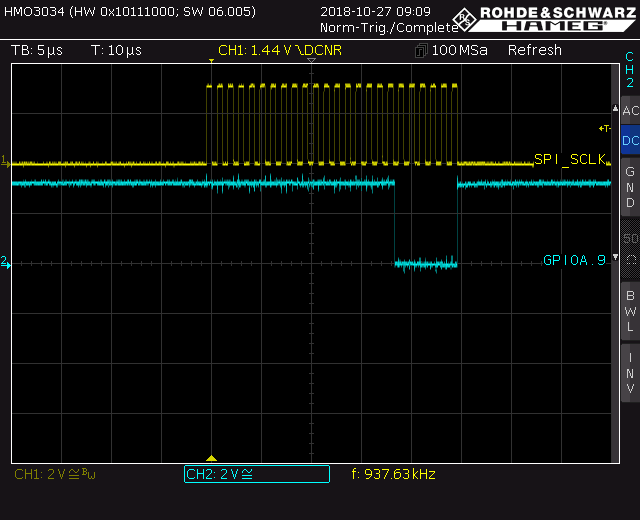

If I hand over one single byte to HAL_SPI_Transmit_IT() it does not work non-blocking as you can see at the following scope.
If I hand over more than one byte (e.g. 3 bytes), HAL_SPI_Transmit_IT() works correctly (non-blocking).
What could be the reason? Why can't I send one single byte in non-blocking mode?

Look at the HAL SPI source code, starting with SPI_Transmit_IT(). It enables the Tx interrupt, which fires immediately because the TX data reg is empty. SPI_TxISR_8BIT() writes 1 byte to the TX data reg. So far so good. But, since your are only sending 1 byte, the SPI_TxISR_8BIT() sees that it is done sending data and calls SPI_CloseTx_ISR() to start shutting down the SPI Tx function. SPI_CloseTx_ISR() calls SPI_EndRxTxTransaction(), which waits for the SPI to be idle before returning. So when sending 1 byte, your call to SPI_Transmit_IT() ends up not returning until the byte has been sent (shifted out), as you see in your scope traces.

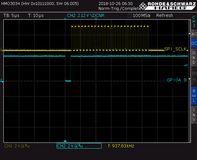

Now let's send 3 bytes.
HAL_SPI_Transmit_IT(&hspi3, buffer, 3);
 /* Check Busy flag */
 if(SPI_CheckFlag_BSY(hspi, SPI_DEFAULT_TIMEOUT, tickstart) != HAL_OK)
 SET_BIT(hspi->ErrorCode, HAL_SPI_ERROR_FLAG);
Please have a look at the scope.
It seems that every last byte is sent in blocking mode.
I can't believe it.

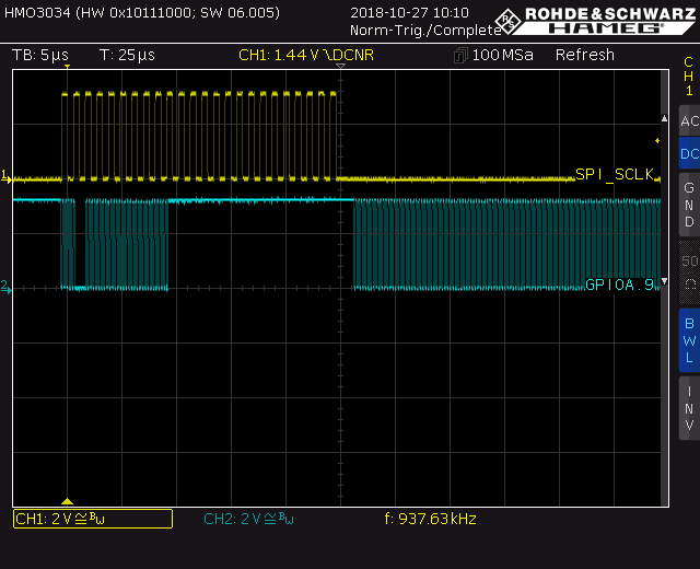

Another test:
while(true) { HAL_GPIO_TogglePin(GPIOA, GPIO_PIN_9); }
This is called "non-blocking transmission". Horrible!

The reason is simple: the "library" wants to ensure that by the time the "finished" callback is called, data are all out. Otherwise, relying only upon the Tx interrupt only it would signal "finished" one frame earlier, when the last frame leaves the holding register and is transferred to the shift register.
