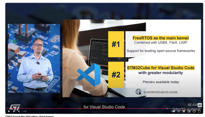

On the keynote speech, I saw that FreeRTOS will be the main kernel.
  • Does that mean that ThreadX will not be offered as an alternative?
  • What is the reason for this change?
  • What about NetXDuo as a middleware?
I am quite happy with how ThreadX and its components worked with each other. Over the years, I have developed several products with NetXDuo, USBX middlewares with ThreadX as an operating system. Not sure why ST is stepping back to FreeRTOS. Curious to know.

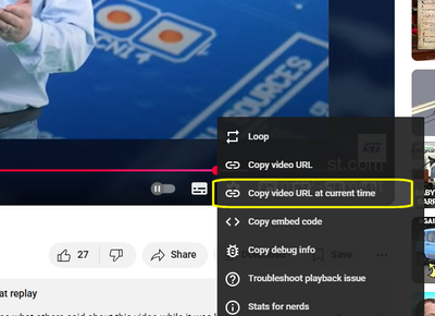

So from the May 2025 STM32 Summit ?
It's an hour-long video - please give a link to where this is actually said.

Ah - this has just appeared: New strategic directions for STM32Cube by @Maxime_MARCHETTO:
Transition to FreeRTOS and enhanced middleware offerings
We are moving back to FreeRTOS™ as the main kernel, integrating it with USBXFileX, and LWIP. This strategic shift will help us build a consistent middleware offering, set to be introduced before the end of this year. Notably, USBX and FileX will be available in both bare metal and RTOS-agnostic versions, providing greater flexibility and adaptability for your projects.

@Andrew Neil
It is around -10 minute mark of the video.
Andrew Neil
May 15, 2025
