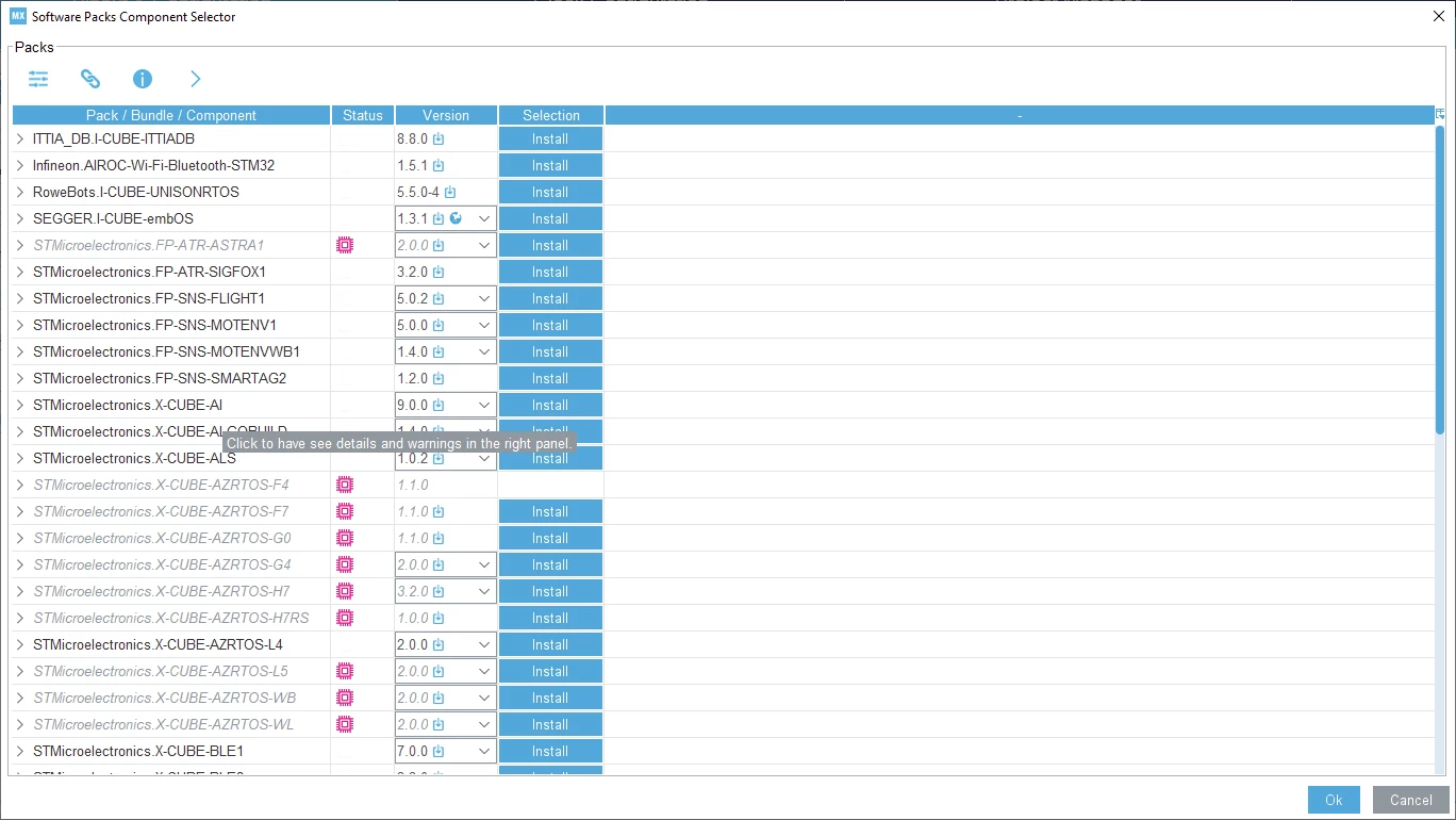

FP-SNS-ALLMEMS1 not found in cube ide
MK..1
Senior
Hi
I am trying to set up a project based on FP-SNS-ALLMEMS1.
When i set up a project based on STM32L476 Nucleo, I cant find the pack neither under "select components" nor under "manage software packs". see below
Why??
Peter BENSCH
Unfortunately, not all software packages are yet integrated in STM32CubeIDE, so that in such cases it is only possible to open or create projects manually. To do this, you can download the firmware FP-SNS-ALLMEMS1, unpack it (for Windows, please use short paths) and open the STM32L476RG-Nucleo projects directly from there, for example.
