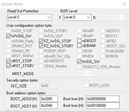

With the use of nDBOOT = nDBANK = 0 option bytes the memory is configured in the dual bank, dual boot mode.
My Current Testing Procedure:
Step 1) I compile the firmwarewhich has a single byte indicating the version of the firmware. I compile it twice once with version byte as 1, and once with version byte as 2. Otherwise its identical code.
Step 2) I use STM32 ST-Link Utility to manually program each version into each bank and run it. I do this for both version with both banks, so 4 times.

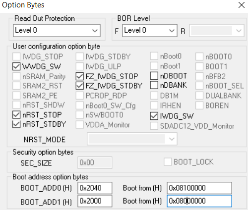

I use the following option bytes to run from bank 1 while programming the .bin at offset for Bank 1:
And i use the following option bytes to run from bank 2 while programming the .bin at offset for Bank 2:0690X00000609fCQAQ.png
All of this up to this point works as expected and im able to read out the different versions from each of the banks.

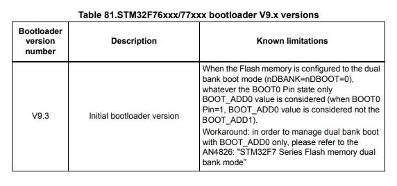

Yuri Andrade Rodrigues
February 21, 2018
Posted on February 21, 2018 at 22:03
Hi Yarema,
Just be aware that BOOT_ADD1 won't work when you have
nDBOOT = nDBANK = 0
There is a Known limitation of the bootloader for this processor. It is in AN2606 document.
They just updated this document this month and it is there still.
