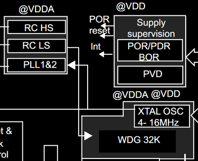

When you boot up, after starting the IWDG, look at reset flags to see if IWDG caused the reset (IWDG_RSTF). If not, then wait until it does.
Note that IWDG has its own clock independent of the common "LSI" clock in the chip. Not sure if this is true or not. The RM suggests it does. CubeMX suggests it doesn't.
Edit: You can update the PR and RLR registers and see that RVU/PVU bits get cleared as a spot-check to see if the IWDG clock is active.

waclawek.jan
January 9, 2024
RCC_CSR.LSIRDY should indicate that LSI is on. In some STM32, LSI is brought in as some timer's channel (e.g. TIM5_CH4 in 'F407), so there its frequency can be observed.
There's probably no direct indication of IWDG running.

waclawek.jan
January 9, 2024
This is consequence of ST poorly handling "integration" (slapping on) of docs of various modules into the whole. While the IWDG chapter, written without the whole in mind for the IWDG specifically, talks about "dedicated low power oscillator"; the RCC chapter has a dedicated "Watchdog clock" subchapter clearly stating that IWDG uses LSI (at least it does in RM0090; I am not bothered to look up the specific 'F401 RM).
