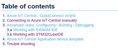

Hi Tech Support Team,
I would like to connect the B-U585I-IOT2A board to Azure IoT cloud using STM32CUBE IDE.
I am confusing on the setup steps.
Should I go through the steps 1 and 2 then follow steps 3.b?
Or just start with steps 3.b?

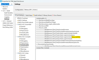

Hi @bay
Can you double check if the paths of files exist and be sure that paths are correct in you STM32CubeIDE project ?
You can update or add non-existing paths as follows:
- go to project properties
- go to C/C++ Build -> Settings -> MCU GCC Compiler -> Include paths
Then correct the paths if paths were wrong !!
If any path is not available, you can add it by clicking on (+) at the top right of include paths windows.
Another suggestions, if all exists and not working, try to avoid any special character like + that I can see in your path.
Try also to avoid very long paths or spaces ....
Below a screenshot showing where to add, verify, remove or correct the paths using cubeIDE. the mouse is on the add button in the screen shoot:

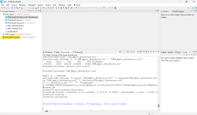

May 7, 2024
Hi CMYL,
I have re-extract the folder into shorter path and remove the special character.
And before and after I added the path, can build the project successfully but with 470 warnings and the TFM_SBSFU_Boot project getting errors.

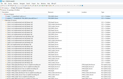

May 7, 2024
Hi @bay
The snapshots contain the warnings,  what is the error messages ?

Hi @bay
There is no information in this snapshot that can help to understand the errors.
Can you start from the beginning of the console and copy the full messages ?

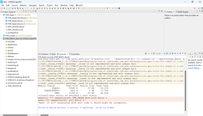

Was there a resolution to this issue, I am having the same symptoms with the STM32CubeExpansion_Cloud_AZURE_V2.3.0 project.
I have added Application/User/syscalls.c to each project in the TFM_Appli project to eliminate the _close() and other syscall.c warnings. Now I have one warning that I cannot resolve:
"C:/ST/STM32CubeIDE_1.15.1/STM32CubeIDE/plugins/com.st.stm32cube.ide.mcu.externaltools.gnu-tools-for-stm32.12.3.rel1.win32_1.0.200.202406191623/tools/bin/../lib/gcc/arm-none-eabi/12.3.1/../../../../arm-none-eabi/bin/ld.exe: warning: TFM_SBSFU_Boot.elf has a LOAD segment with RWX permissions"
I don't think this warning is causing my linker to error out, I have turned on all the verbose flags but still don't see an error.  Attached is the full output.
The project is on the root of its own drive so path issues mentioned before should not be a problem.
Any help or information would be
Visitor II
December 3, 2024
To resolve the linker warning which does stop the link process in the TFM_SBSFU_Boot project was to add (READONLY) callout to various > FLASH sections in the stm32u5xx_s.ld file:
.ARM.extab : ALIGN(4)
changed to
.ARM.extab (READONLY) : ALIGN(4) /* The READONLY keyword is only supported in GCC11 and later, remove it if using GCC10 or earlier. */
The following sections also need to be changed:
.ARM.exidx (READONLY) : /* The READONLY keyword is only supported in GCC11 and later, remove it if using GCC10 or earlier. */
.zero.table (READONLY) : /* The READONLY keyword is only supported in GCC11 and later, remove it if using GCC10 or earlier. */
.copy.table (READONLY) : /* The READONLY keyword is only supported in GCC11 and later, remove it if using GCC10 or earlier. */
They should be changed to prevent the warning in all the project's .ld files
but in the other projects, the linker does not stop.
I hope this helps someone else find this issue faster than I did.
