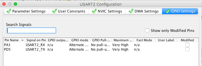

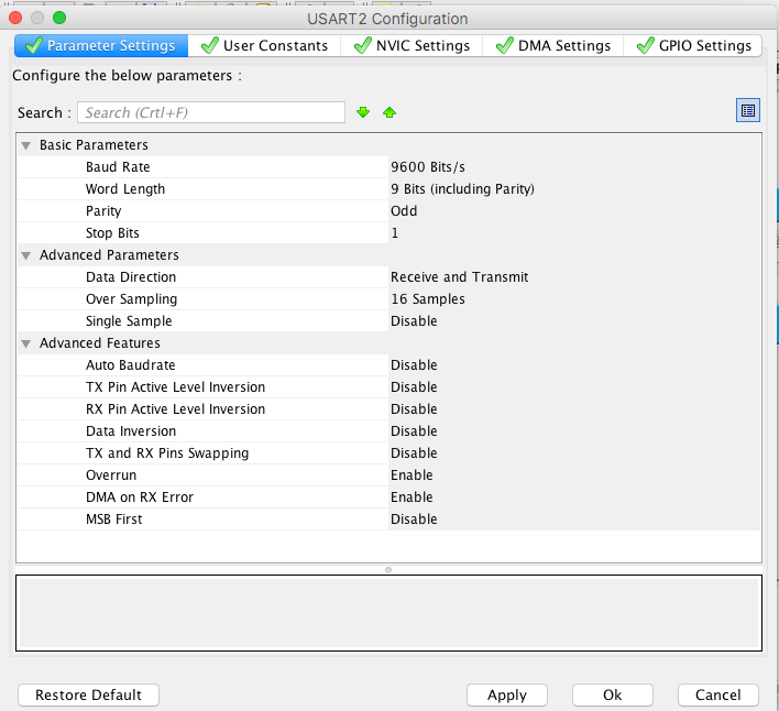

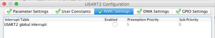

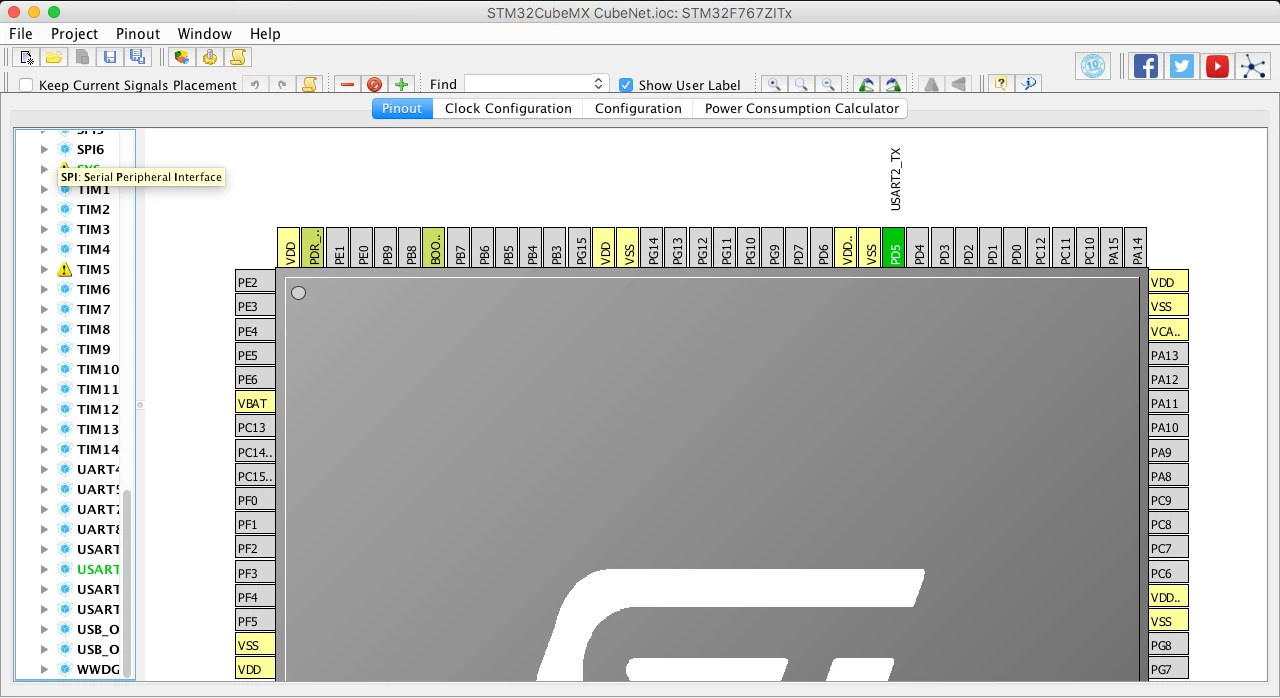

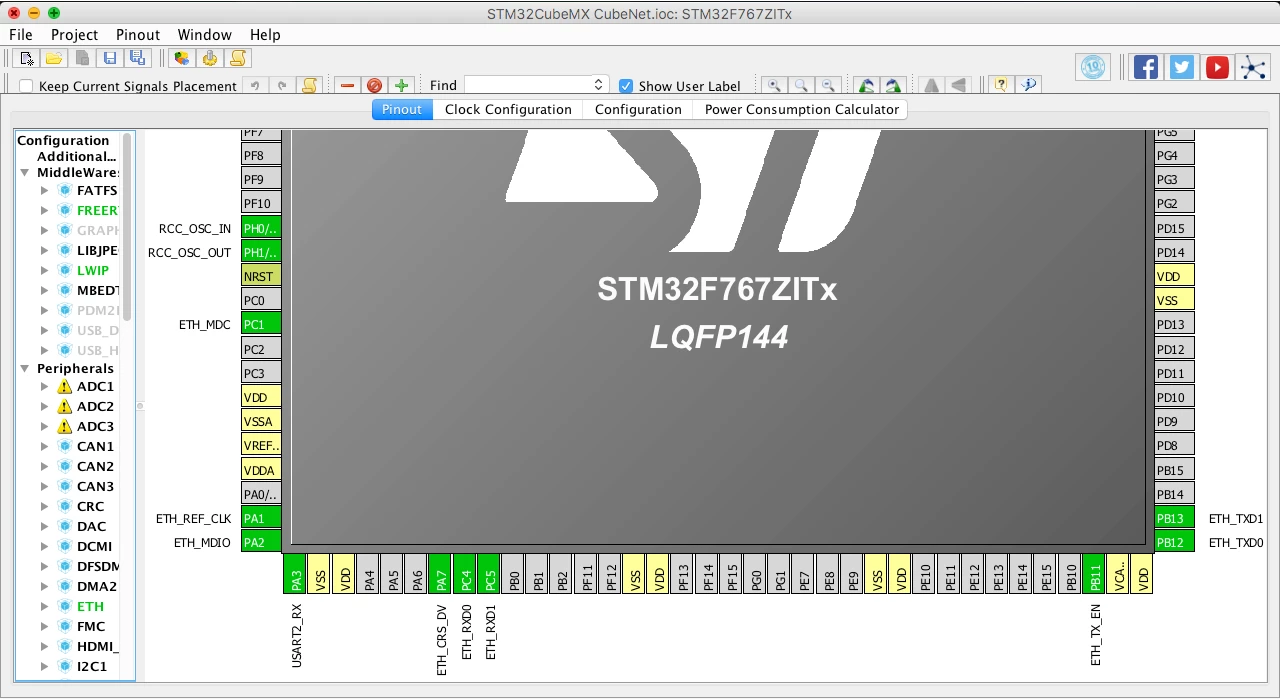

Hello. I'm doing CubeMX generation, but earlier I also copied bits of firmware UART printf example. Tried with USART1, USART3, USART2.   HAL_UART_Transmit(&huart2, ''Hello\n'', 6, 0xFFFF); doesn't yield output (i.e. zero reaction on serial console app; running simultaneously openned project derived from firmware-example works, without touching the serial application; UART parameters like parity etc. is the same).

My board is Nucleo-144 F767ZIT6. I can run the firmware UART printf example and it works. Can anyone help?

did you intentionally enable ODD parity for USART?
Best regards,
Tilen
Sebastian Gniazdowski
April 4, 2018
Posted on April 04, 2018 at 15:43
Yes, and selected 9 bits, knowning the HAL-thing that the bits are including parity. I will state also here, that I get zero reaction in terminal app, while clicking 'run' in SW4STM32 on an example-derived project (different project open simultaneously) works.

The example presumably uses the VCP, which is USART3 on PD8/PD9
I would make sure to enable the GPIO clocks at the point where I initialized the pins.

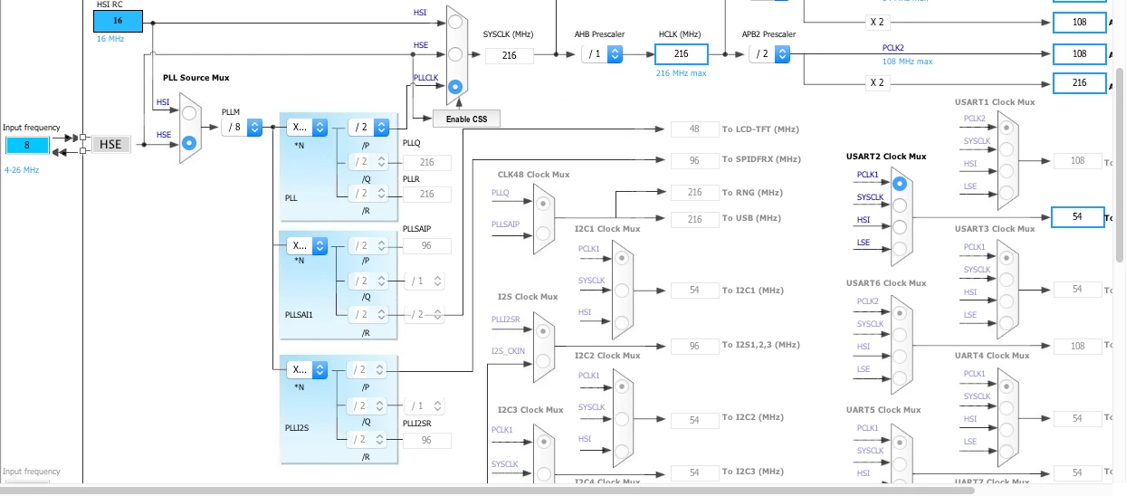

>> RCC_OscInitStruct.PLL.PLLM = 25;
Pretty sure the board is using an 8 MHz clock, not a 25 MHz one, make sure PLLM is set properly, and that HSE_VALUE in stm32f7xx_hal_conf.h is 8000000

Thank you, the firmware example uses 8* in both places, I indeed had HSE_VALUE set to 25000000, weird, It didn't help the UART problem. I'm sure I have correct board selected, proved that once in forum, pasting lines from file *.ioc:

I have now edited .ioc and changed the fields to:
RCC.HSE_VALUE=8000000
RCC.PLLM=8
I've reloaded the project in MX, I was counting on some clock issue to be reported, but nothing. I do following to test the serial communication:

See earlier message about using the correct PLL settings and HSE_VALUE, compare those to that of the working printf example.
