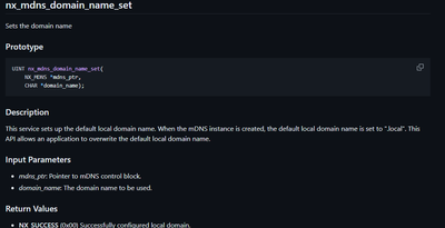

I am using Azure RTOS with NetxDuo, I implemented a secure https server in my device and implemented mDNS which was working very well for me till I required to change domain. I want to add a sub-domain like (myhostname.mysubdomain.local). In documentation it is stated that by default the domain is .local but can be changed using following API

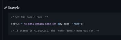

status = nx_mdns_domain_name_set(&mdns_instance, "home");
status = nx_mdns_enable(&mdns_instance, PRIMARY_INTERFACE);
It returns success and according to the document I must be able to ping hostname.home but thats not the case not matter what I done it will be always accessible through hostname.local
I checked the domain name buffer inside mdns_instance, its updated to home but even then changed domain is not accessible.

sorry to hear this another suggestion maybe to use the API call as follows:
status = nx_mdns_domain_name_set(&mdns_instance, "hostname.home");
