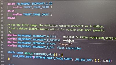

I can upgrade application firmware however, as soon as I change the size of the image slots the MCUBOOT bootloader on stm32 chips mcuboot does not upgrade the image after the download is complete and complains
E: Image in the secondary slot is not valid!.          (image attached)
Then the mcuboot fallback to the primary slot image after reset.
On reverting back the size of the slots it works again every time.
I have put some debug messages in mcuboot which shows the hash mismatch issue (image attached for code snippet with debug message from MCUboot code)
Can anyone please suggest what can be potential solution for MCUBOOT bootloader upgrade over the air on STM32 chip or are there any specific changes required in MCUboot from zephyr to make it work with STM32 so that the change in the slot sizes can be accomplished without any issue as long as it is meeting the logical criteria of being within limit of the 2MB and size of the slot is divisible by 8K(sector size) and both slots primary and secondary  are same size with scratch partition at least a sector size?

Best answer by A Maq
It turned out that the issue was due to the hardcoded address being used in the code as shown here.
Fixed with use of zephyr code extracting the addresses from dts as shown in below screenshot:
1 reply
