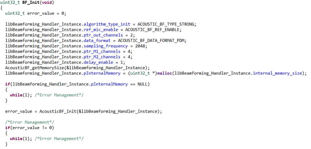

I'm trying to setup the SMARTMIC package on my STM32H743 board with the CCAO2M2 board and MEMS microphones, and I want to use the beamforming library (AcousticBF version V2.2.0).

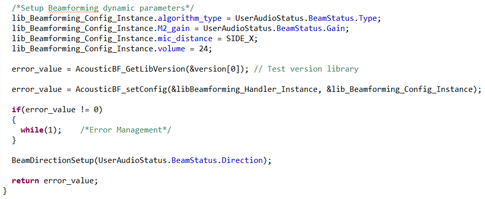

But when i call the BF_init function, I pass in the HardFault_Handler function at the AcousticBF_setConfig function call.
0693W00000APsYWQA1.png0693W00000APsYgQAL.pngI've tested many things and i noticed that when I comment the SIDE_X line (SIDE_X = 147) we don't pass anymore in the HardFault_Handler function.

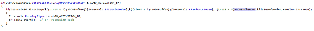

I have the same problem when i call the AcousticBF_FirstStep function : even if I comment the SIDE_X line in my initilization, I still pass in the HardFault_Handler function.

@Imen DAHMEN​ Thank you for your great help. I have receive today from an ST Support a new version of the AcousticBF library that works with STM32H7 board. So my problem is solved and my project compile correctly now.
