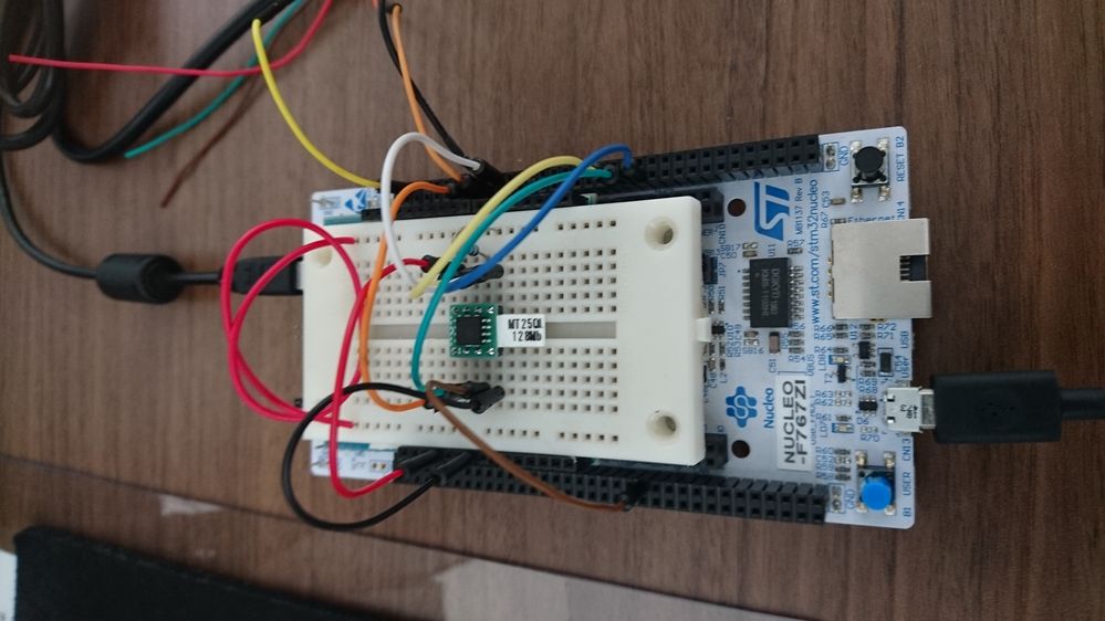

Goemon
GoemonAuthor
October 16, 2020
0693W000004JyeyQAC.jpgHi,
Thank you your help.
I tested it with a simple program to see the basic reads and writes.
After writing the data to FLASH, when I compared it with the read data, they all matched.
So I think both writing and reading are working properly.
However, it will fail unless the clock rate is lowered.
Is there a hardware problem?
Best Regards,​
