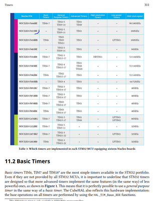

According to this pdf p340 ( https://www.embedic.com/uploads/files/20201008/Mastering%20STM32.pdf ), TIM6 doesn't exist on STM32F4 boards:
So this macro __HAL_RCC_TIM6_CLK_ENABLE() shouldn't have been called in a STM32F4xx driver isn't it?
Should I create an issue on the Github STM32CubeF4 ( https://github.com/STMicroelectronics/STM32CubeF4 )?
It exists on some STM32F4 chips, just not yours.

Hello again @MasterHans
This drive is for all the stm32f4 not specially for the F411 nucleeo. There is other F4 boards that contains TIM6 (the F407 disco for exemple). This macro will be included by CubeMX just when you use a board that support TIM6 not for all boards.

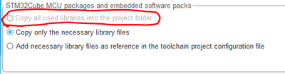

If you enable them in CubeMX, they will be copied over, but otherwise no, you need to manage them yourself.
There used to be a way to copy all HAL files, even ones that were unused, but it is grayed out in recent versions.
You just have to desactivate the generate under root, and the grayed option will be available.
Best regards.
II
