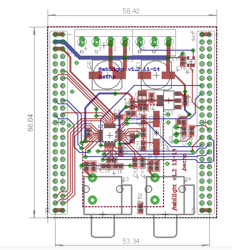

I want to create PCB on top of which I will be able to plug in the Nucleo-144 board. What should I order, can anyone share advice? I tested that board's pitch of the bottom pins is 2.54 mm (because 2.54 mm ribbon cable fits, UM doesn't mention ''pitch'' word nor shows this on the mechanical drawing). The PCB for discovery board that I need to edit is following:
Pitch between the holes on left and right is correct, 2.54 mm. But what part should I use to be able to plug in the Zio pins that are on bottom of Nucleo? After I change PCB to have  2x10 (CN7), 2x8 (CN8), 2x15 (CN9), 2x17 (CN10) series of holes, to match Zio. Is my approach overall correct? I'll be transmitting DCMI data.

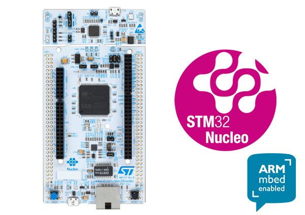

Posted on February 05, 2017 at 19:00
Nucleo 144 looks like this:
The 4 black female pin headers around the QFP144 are compatible with Arduino Uno (2.54mm pitch) except that more signals are accessible by doubling the rows. (they mismatch from the presented bottom board layout).
I guess the unpopulated left and right dual row connectors are called ''MORPHO'' connectors as in the Nucleo 64.
In both cases classical dual row 2.54mm pitch headers.

SSW-136-01-T-D by SAMTEC is working for us.
 Cut these to length in a band saw, and avoid distributor delays while they cut it to length.

I am not sure we are on the same page. We are soldering the SSW-136-01-T-D on our base board and plugging the Nucleo-144 directly into our matching cn7, cn8, cn9, cn10. Alignment is a pain with the left pair since ST preferred matching someone else's setup, instead of looking past that. At this stage we are not using the outside double row of holes on the Nucleo - cn11 and cn12. We are not yet shipping in volume. Stage 1 is getting a part that is available and works. Are you in North America?
