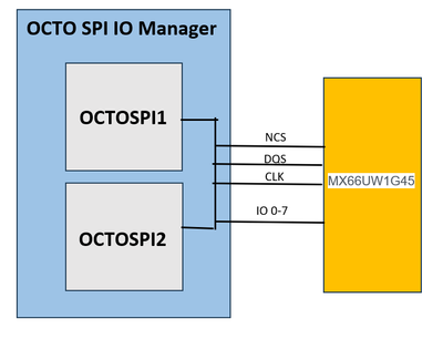

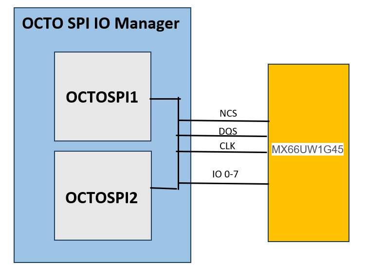

Hi @KDJEM.1 , Thanks for you reply .
In STM32U5A9J-DK the OCTO SPI IO manager has two OCTOSPIs instances (OCTOSPIs Host controller) OCTOSPI1 and OCTOSPI2 and both of them shares the same IO lines in multiplexed mode . In RWW mode we need to have two octo spi host controller (OCTOSPI1, OCTOSPI2) and both of them can access the HAL driver in parallel to perform read and write on the external flash. I have attached one image here for your reference , please correct me if my understanding is wrong.
Do you have a RWW example for STM32U5A9J-DK which uses OCTO SPI interface , this will be a great help.

Tesla DeLorean
Guru
June 28, 2024
I'm saying that the OCTOSPI peripheral does not have multiple contexts to hold different concurrent conversations with the memory IC, so you must arbitrate ownership of the peripheral so it completes whatever operation and phases it's currently involved in, before the next set of operations can start.
I also don't see anything in the MX25UM51245GXDI00 documentation to indicate it can have multiple contexts/threads of operation of read/write, or any queuing methods.
https://www.macronix.com/Lists/Datasheet/Attachments/8967/MX25UM51245G,%201.8V,%20512Mb,%20v1.5.pdf
There are also not separate read / write channels to the MX25, that would facilitate "at the same time" operation you're suggesting, these things would need to be done in a linear, time separated fashion.
The STM32 might be able to operated two different OCTOSPI peripheral/buses "concurrently" to the extent that they can act autonomously, and process data, whilst contending/arbitrating bus/memory usage with other devices vying for resources.
