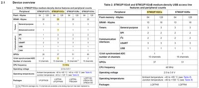

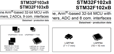

mƎALLEm
As already suggested STM32F103 is the best choice to replace STM32F102 as the first one has extra features vs the second.
F103 is the performance line of F1 series running up to 72MHz while F102 is the access line of F1 series running up to 48MHz.
According to their respective datasheets:
Available packages:
Features and available peripherals:
I highlighted the differences by marker.
Hope it helps.
