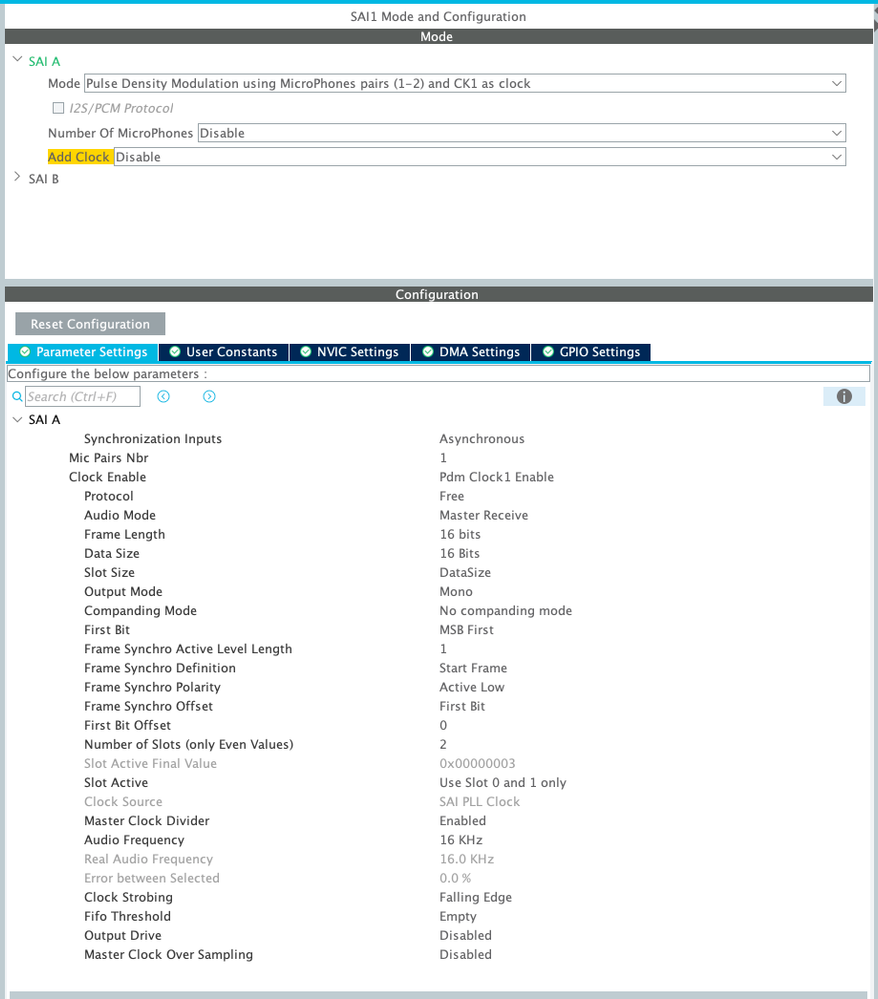

In CubeMX I activated SAI1, set the following options:
  • PDM
  • Mono
  • 16khz (SAI1 clock set to 40.96 MHz)
  • 16bit data/frame

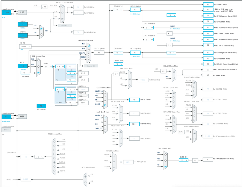

In clock configuration:

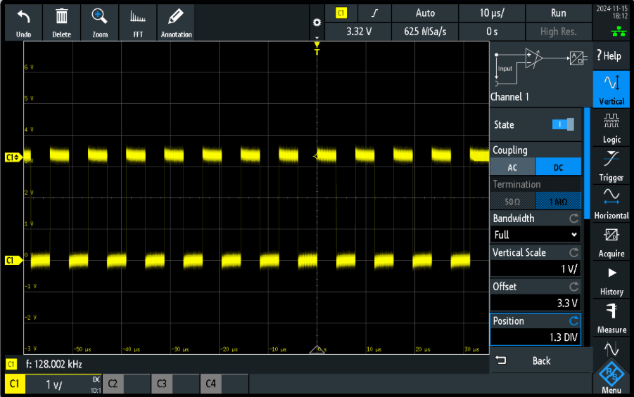

If I probe the SAI1_CK pin (PB8) I see a 128 khz clock. Obviously this is too less and not correct, what am I overseeing here? Maybe a bug?

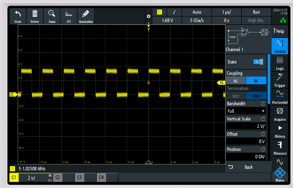

Remyhx
RemyhxAuthor

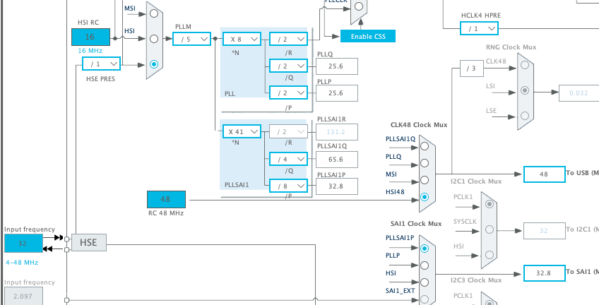

Nov 17, 2024 10:14 AM UTC
Not the most scientific way of solving... (Is it solved?)
Need a clock of 1.024 mhz for the mems mic. Audio rate 16.000 hz, oversampling x64 -> 1.024.000 hz

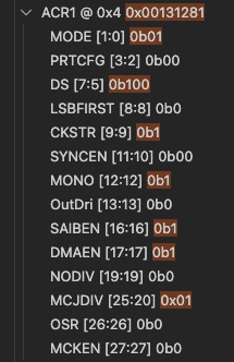

I was poking around with the MKDIV setting in register ACR1 (SAI), put it back to 1.
SAI1_Block_A->CR1 &= 0xFC0FFFFF;
SAI1_Block_A->CR1 |= 0x00100000;
//Or
SAI1_Block_A->CR1 &= ~SAI_xCR1_MCKDIV;
SAI1_Block_A->CR1 |= SAI_xCR1_MCKDIV_0;
If I use these clock settings it is almost 1.024 mhz:
And the oscilloscope:
Especially the PLLSAI1R value is important. If I change To SAI1, it seems unpredictable.
The register:
(MCKDIV is mistakenly written as MCJDIV)
