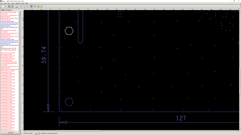

Unfortunately, I am still loosing the needed information. On KiCad, i am not able to open the Gerber Drill files. Get the error message: "Tool 0 not defined".
All I need is the exact position of the CN8 and CN5 and the 4 drill holes for the MB1166.
Would really appreciate your help!
Johannes
August 17, 2021

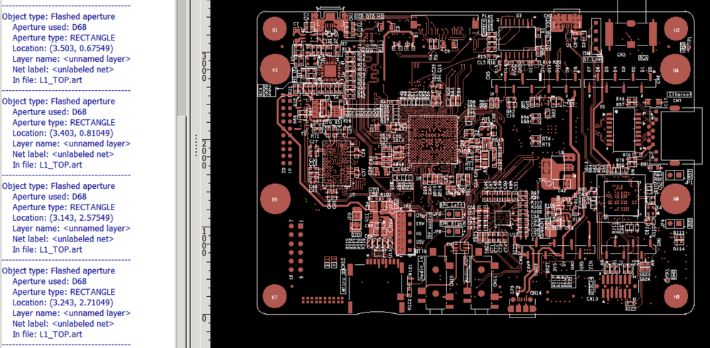

Open the Gerber files directly with gerbv and you can find individual hole locations.
JSchn.4
JSchn.4Author
August 17, 2021
@TDK​ , thanks again for the quick response.
Unfortunately, I can only assume the exact measures, since gerbv does not have access to the properties of the element. See attached screenshot0693W00000D2gNNQAZ.png
August 17, 2021
I’m 100% sure it’s possible to get this info out of gerbv with the appropriate gerber file. But I’m not in a position to do it right now. If you ping me again in a week, I can.

August 27, 2021
The .ART files are the Gerber files to look at. Looks like you are looking at a dimension file.
To center of mass from left side (x=0) and bottom side (y=0):
CN8: 3.453, 0.743
CN5: 3.193, 2.643
I can't find the datasheet for the LCD. The radius is probably in there.
