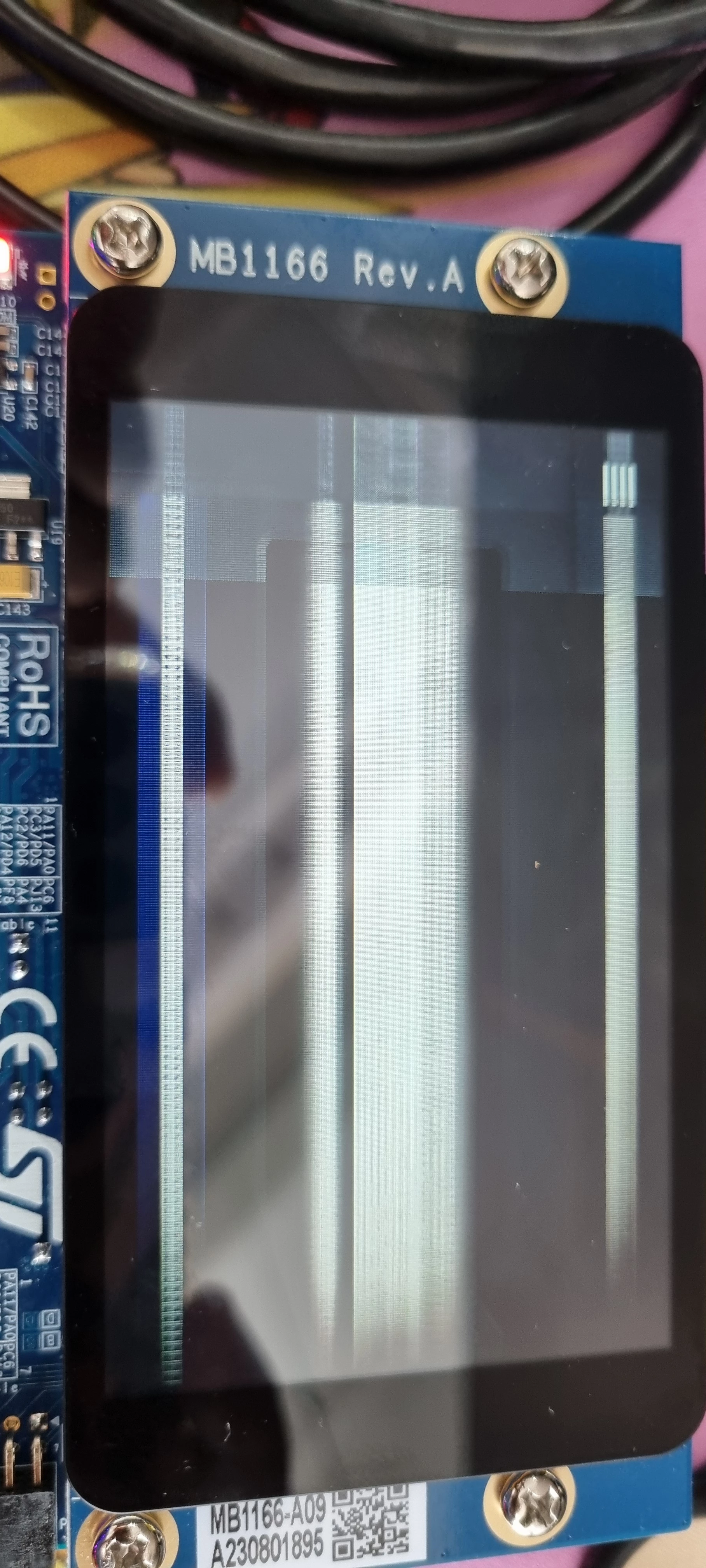

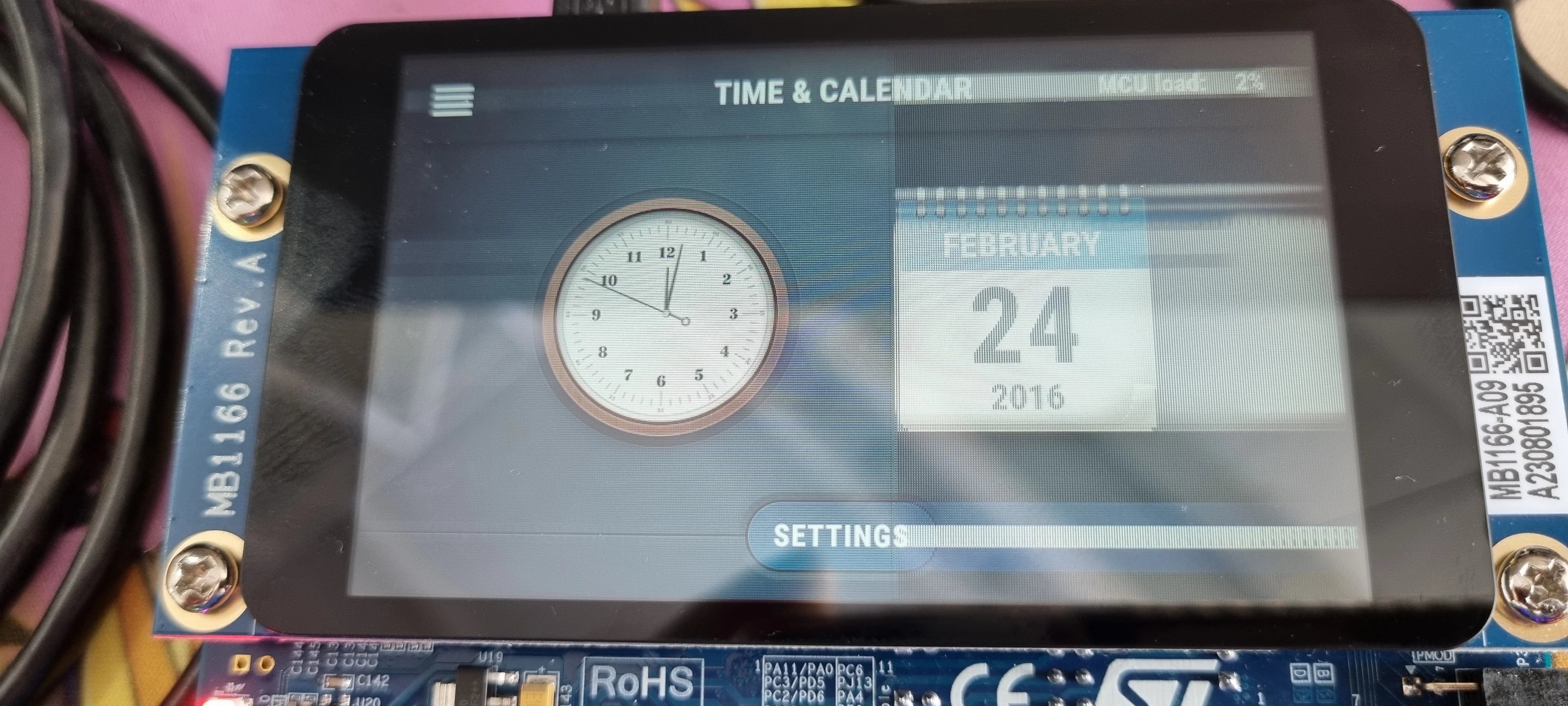

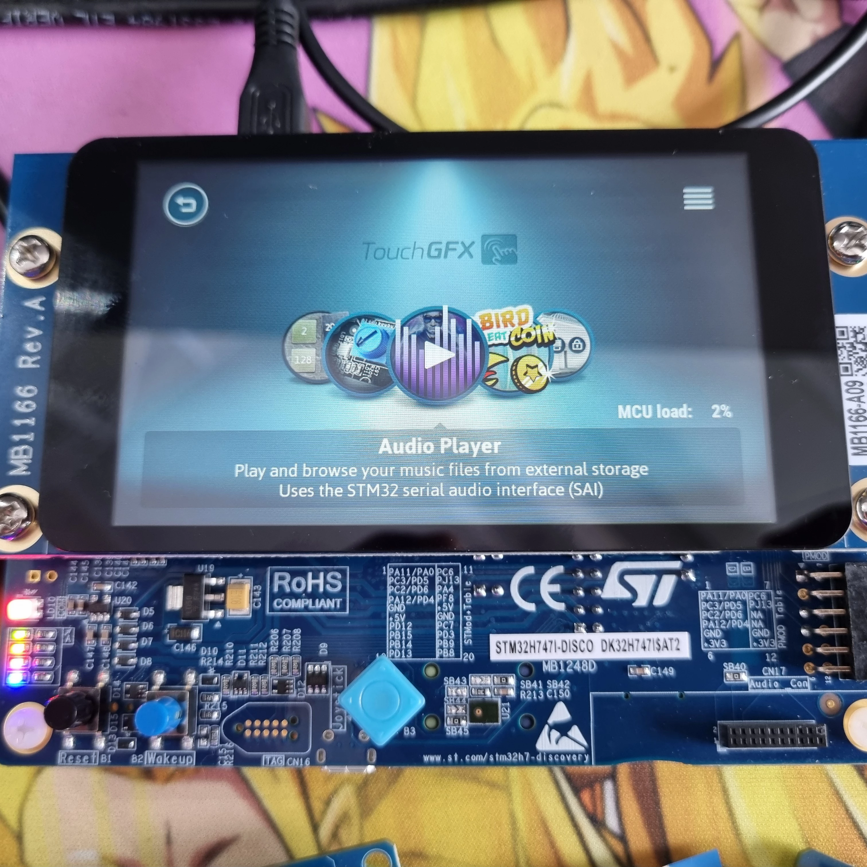

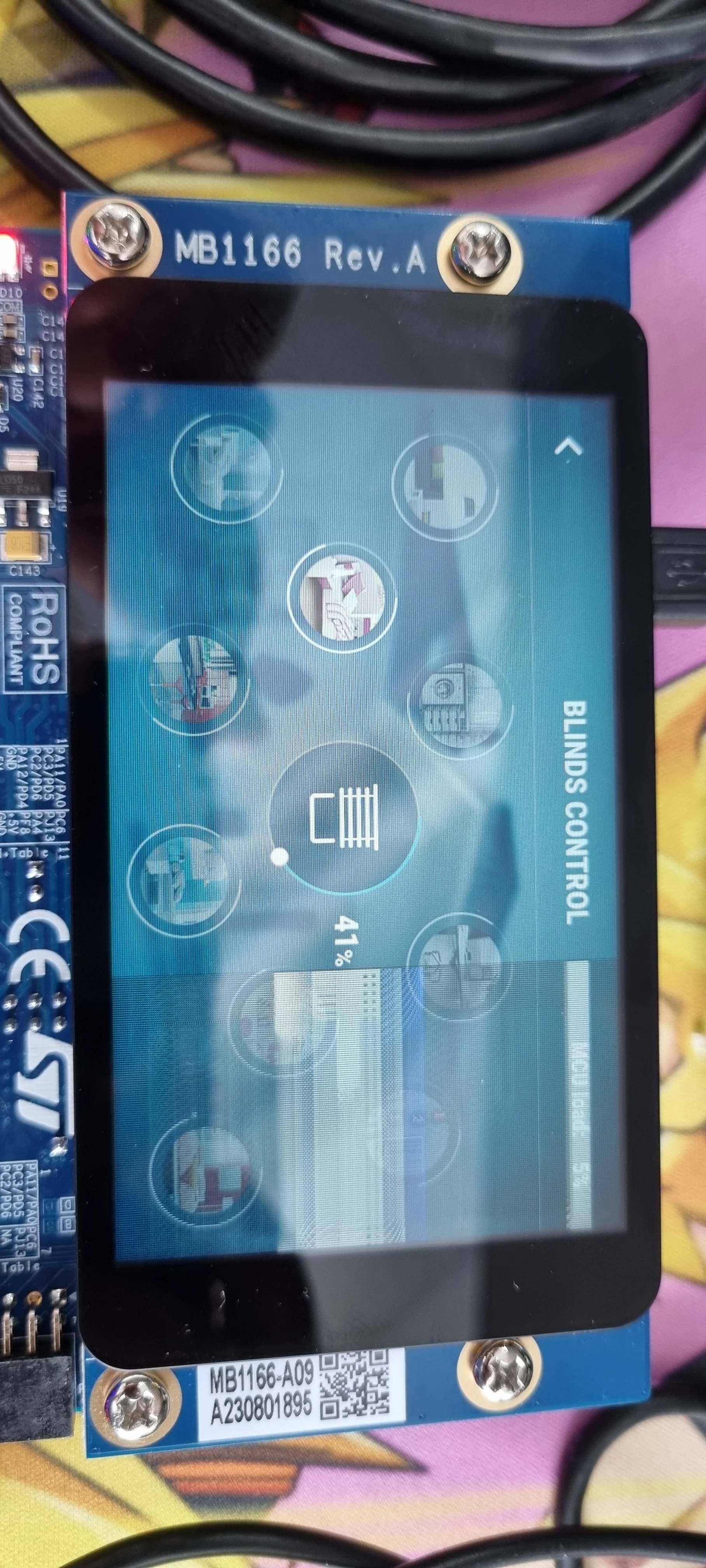

Good afternoon everybody,
I bought an STM32H747I-DISCO, and installed the TouchGFX demo software.
When I turned on the board, the demonstration ran perfectly on the LCD display, but after a few seconds, the images on the display started to show problems, as shown in the photos.
If I disconnect and connect the USB cable, the problem continues, but if I disconnect and wait a few minutes, and turn it on again, the display starts perfectly and after a few seconds the problem appears again.

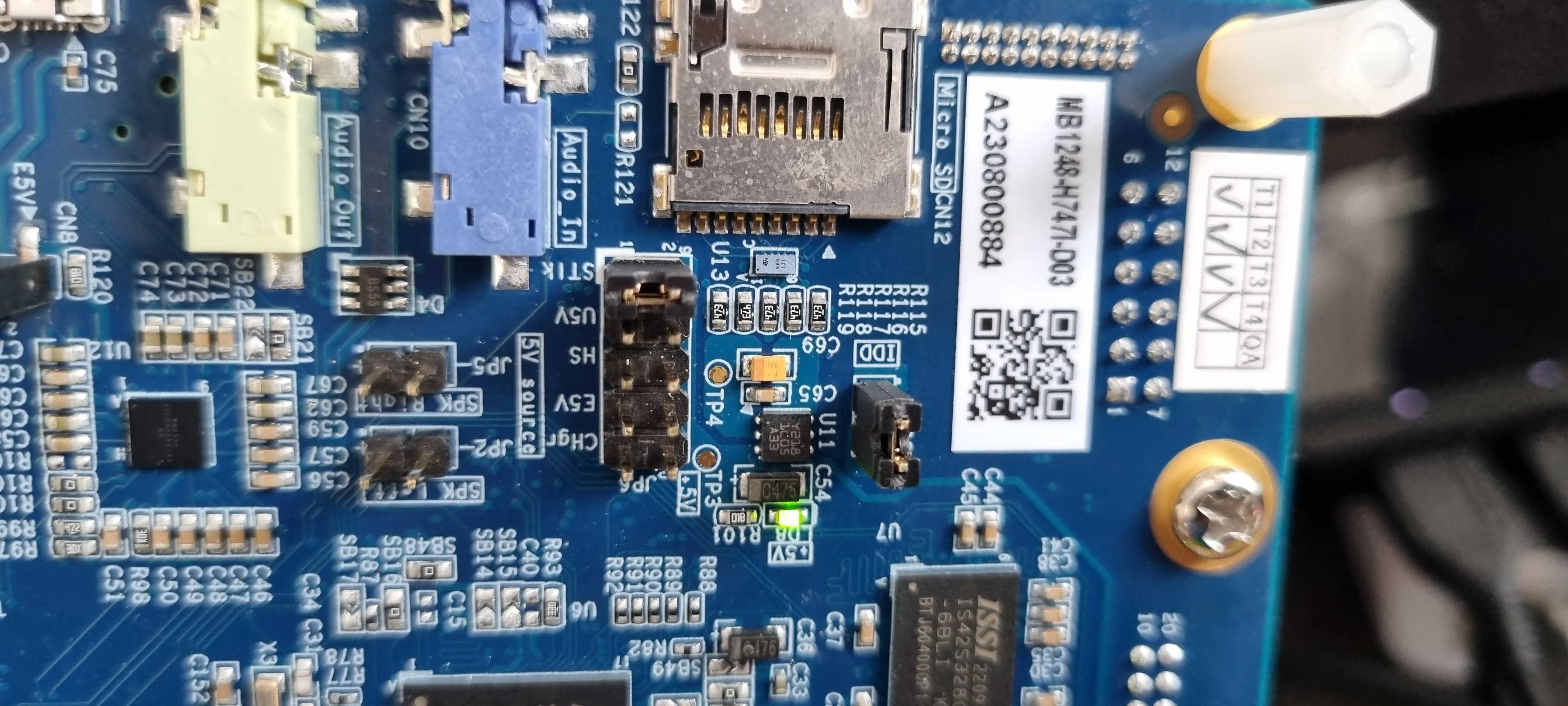

I'm using St-Link v3 USB power.
Has anyone had this problem?

mƎALLEm
February 23, 2024
It could be an issue related to the LCD.
If you have a chance to have another LCD, could you please do a test with it?
February 23, 2024
I have another one in the box. I will open it to test.
I'll let you know the result soon.
