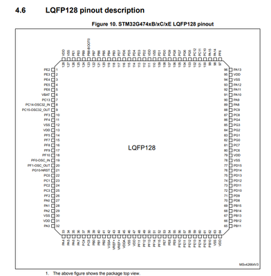

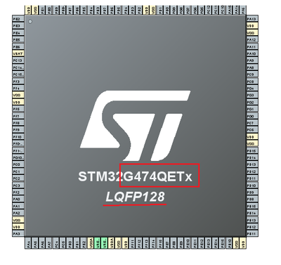

Where is the stm32G474QET6TR pinout figure?
I cannot find it in the datasheet.

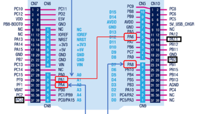

I need to know which pins on the board are PC3, PA11 or PB2.

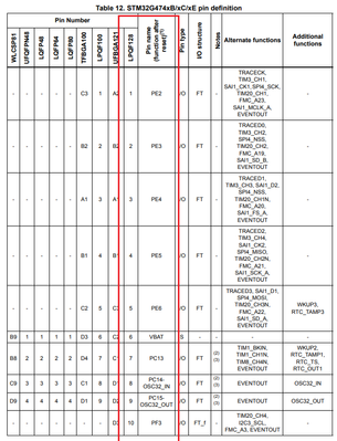

For this you need to refer to the datasheet of the MCU and not to the board UM.
https://www.st.com/resource/en/datasheet/stm32g474cb.pdf / Table 12. STM32G474xB/xC/xE pin definition
Figure 10:

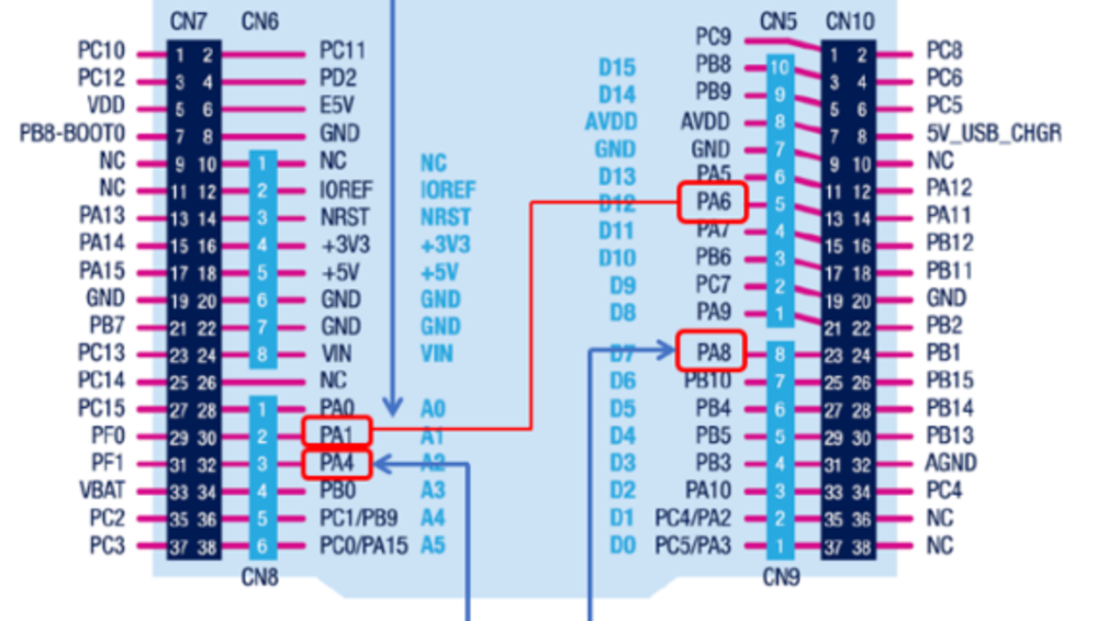

SofLit
The board's pinout description are provided in UM2505 / tables Table 15. for ARDUINO® connectors pinout and Table 16. for ST morpho connectors.

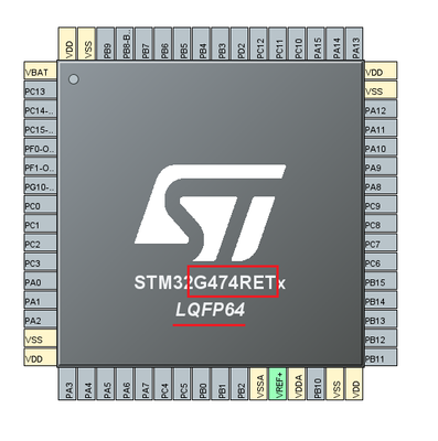

This MCU "STM32G474QET6TR" is not used in any board.  if you are tooking about the Board that you are sharing, here are the 3 Pins:

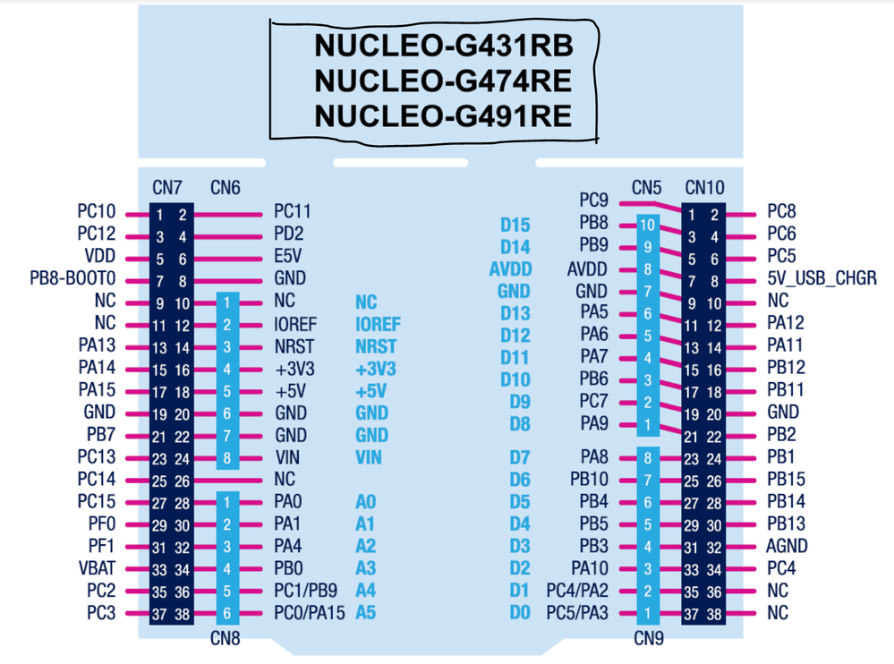

Thanks. I found the figure in UM2505, but the figure is for G431RB, G474RE, and G491RE.
Is the figure also suitable for "G474QET6TR"?
I didn't understand!
"G474QET6TR" device is a 128 pin package:
While G474RE used in the Nucleo board is a 64 pin package:
So the 128 pin package is not compatible with that Nucleo board.
So could you please explain what do you want to do?

I want the pinout figure for "G474QET6TR".
I only found the "G474RE" pinout figure.
I didn't found the pinout figure for "G474QET6TR" in its datasheet.
Do you know where is the "G474QET6TR" pinout figure?
Figure 10:
