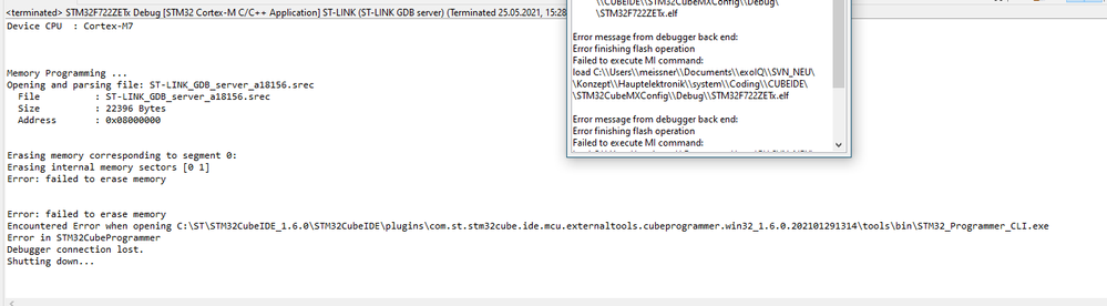

I debuged my software on the STM32F722ZE, when I suddenly lost connection to it. I tried to connect to it with ST-Link V2 and Segger J-Link.
Error message from J-Link commander is: Can not attach to CPU. Trying connect under reset. Connecting to CPU via connect under reset failed.
Error message from ST-Link V2: Error finishing flash operation. Failed to erase memoy.
See picture: 0693W00000APoBiQAL.pngI then took a look at the config with CubeProgrammer:

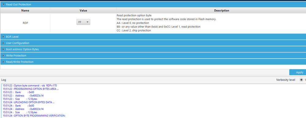

0693W00000APo8yQAD.pngHow is it possible to have 0xFF as RDP Byte?
0693W00000APoCHQA1.pngWrite protection is not active are all checked.
When I try to perform a mass erase I get Error: Mass erase operation failed.
How can I recover from this? Is it possible that I locked myself our by acciedent? I would say it is rather unlikely to do this while debugging. What else could have happend?

Houda GHABRI
Hi ,
I already check this issue and we are not able to reproduce it , The mass erase is done correctly in STM32F722ZE ST board.
Let's check again if we have the same scenario :
  • Is it an external Flash Erase or the internal ?
  • Can you please also share the option bytes state of a failing board, a full dump of Option Bytes can be done with CLI command : STM32_Programmer_CLI.exe -c port=swd -ob displ
