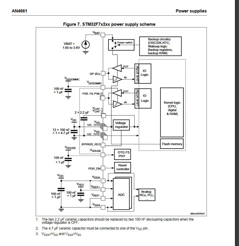

Power supplies:
The device needs a supply of 1.8V to 3.6 V.
http://www.analog.com/media/en/technical-documentation/data-sheets/ADM7pdf
I'll connect this to all peripheral supplies of the device(sdmmc and usb, etc.), therefore I can ignore the
https://imgur.com/DU8VCWP
I've also followed the following overview of the power supplies for the stm32f722ze:
And I've added all the specified parallel capacitors and followed the footnotes shown.

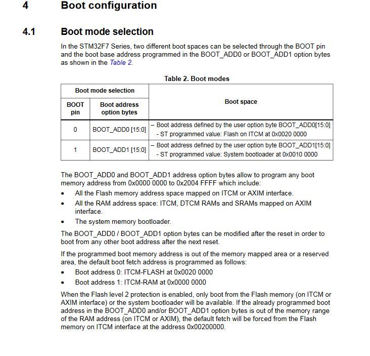

Boot mode
For the bootmode, there are a few different sequences shown in the manuals and application note an26
https://imgur.com/plRJ6PI
patterns that can be applied depending on the chip.
https://imgur.com/YSyJwv7
. I'm not sure how to apply this to the board though.
I've read the following section from the ''Getting started with STM32F7 Series MCU hardware development'' application note. It seems that setting pin boot0 to 0V loads from flash and setting pin boot0 loads from flash? I'm not too sure about this though.

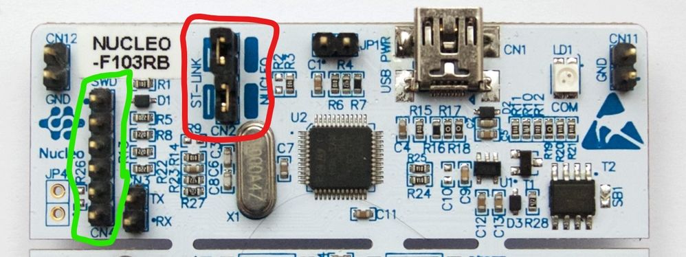

Debug management
To debug the board I plan on implementing the ST link that the nucloes come with.
It seems that I only need to decouple the jumpers(shown in red) and then use the swd pins shown in green to debug the board. I'll couple the pins shown in green to my custom board.

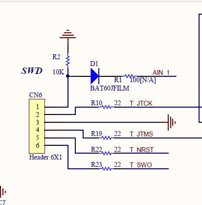

Looking at the nucleo-f722ze schematic for the header pins (shown above), I'm assuming I only need the following pins:
pin 2 : T_JTCK (SWCLK)
pin3 : connect to ground
pin 4 : T_JTMS (SWDIO)

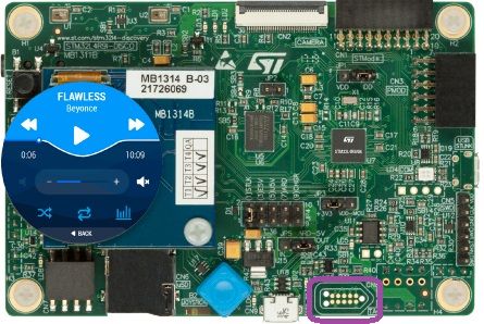

In addition to the jumpers marked in RED, one should also watch for SWO, NRESET which have common connectivity with the target. Check solder bridges to achieve more complete disconnection.
I would generally recommend using a standard 10-pin SWD connector, or older style 20-pin JTAG (SWDIO, SWCLK, SWO, NRESET subset). The local FAE likes the Tag-Connect system and some of the newer DISCO boards have such foot prints. I like edge castellations over test points.

Just another question. I'm a little lost on the boot configuration. If I'd like to boot from flash, I'm assuming all I need to do is set the boot0 to 0V?
Are you referring to the SWO,NRESET,etc. that I marked in green on the stlink?

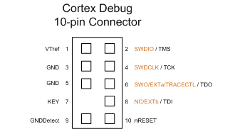

I also have a quick question about the connector. If I use the 10 pin SWD connector:
I went through the connections, although it doesn't seem that I can directly connect this to the nucleo-f722ze's st-link? Would I need to design my own link if I plan on using this connector.
I used
http://www.support.code-red-tech.com/CodeRedWiki/HardwareDebugConnections
which seems to cover the majority of the required connection pins and pullups.
Thank you for all the help.
Posted on February 28, 2018 at 18:34
The SWO, NRESET are at the green header AND connect to the TARGET processor on the Nucleo board.
The 10-pin header uses the same signals, it is just a standard rather than one pulled out of the air by ST.
Connects to an standalone ST-LINK, J-LINK or U-LINK, and there are adapters from the standard 20-pin header if that's too big for your application.
Tag-Connect test points
Posted on February 28, 2018 at 19:08
