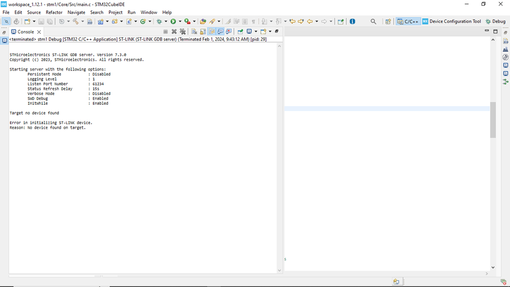

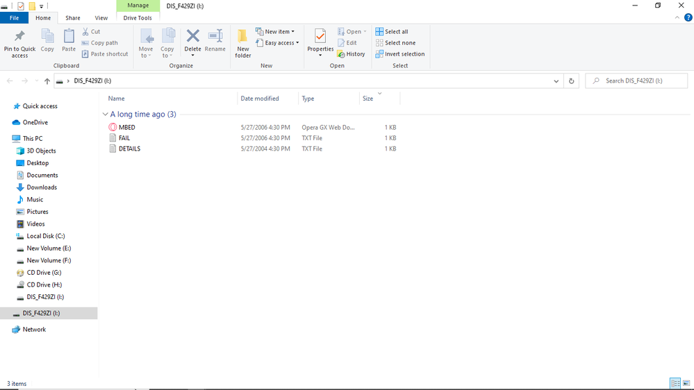

Screenshot (10).pngScreenshot (11).pngThe stm32f429 disc1 board is throwing this error once I connect my board.
The interface firmware FAILED to reset/halt the target MCU.

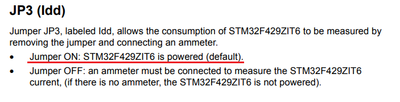

Check if JP3 is already fitted:
I have a doubt that it is not fitted, therefore the MCU is not powered on.

Hello @harry123
Have you tried to upgrade your firmware?  If so, can you try using a data cable and also try another USB port on your PC.

Have you tried to upgrade your firmware? -->No
If so, can you try using a data cable and also try another USB port on your PC?   Yes tried it but there is no change.
