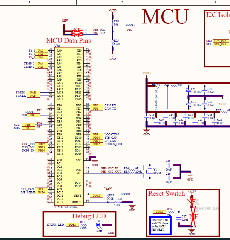

Hello, I have a STM32F407VGT6 built into our application, During developement Iam facing some strange issue where NRST pin goes below logic level over the time(in few days), This issue happens in some of our boards. Our Circuitary only contains 0.1uF Capacitor connected across NRST pin and i assume there is internal circuitary which pulls NRST pin high so I have not connected any external pull up. I have tried replacing Cap but it didnt solve the issue. Now, I am planning to connect 10K strong pull up resistor across NRST pin. So, Could you please suggest if it is fine to add external pull up to NRST Circuit and please explain what could be the reason for the issue.

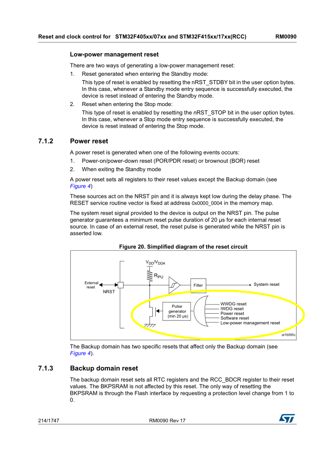

> Will internal Software Reset or watchdog reset drive that external NRST pin?
Yes.
It's fine (but unnecessary) to add a 10k external pullup, but it's unlikely to solve the issue. Probably, the chip is being reset internally due to a watchdog, BOR or other circuitry. Instrument the code to output the RCC_CSR flags on startup so you can see the source of the reset.

My guess is a brown-out reset. Or damaged hardware. Or improper schematic/design.

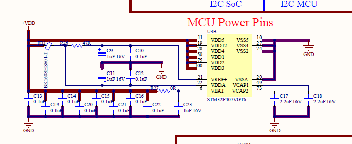

My guesses are above. Attach your schematic if you want. Verify VCAP/VDDA voltages during the problem.
Vb.21
Vb.21Author
October 12, 2021
