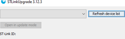

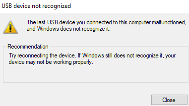

I have STM32F4 DISC board and I worked with it several weeks. It was working correctly but today when I was set a SPI connection with other stm32f030 mcu, I plug-in and plug-out usb cable and I got "USB device not recognized" error message.
I didn't change anything.
When I was plug-in, power led on board lighting dimly. Is this a sign for corruption of card??
stm32cude ide can not detect stm32 disc board.
Thanks for any help

Have you tried restarting your computer and/or docking station? Every once in while I get similar warnings and after power cycling my docking station, the USB ports start working again.

I restart computer and also uninstall and install driver st-link v2 but. doesn't change anything.
Power Led and LD8 led always on.
I found something : "LD8 (red LED) indicates an over-current from connected device", is this related my issue ?
