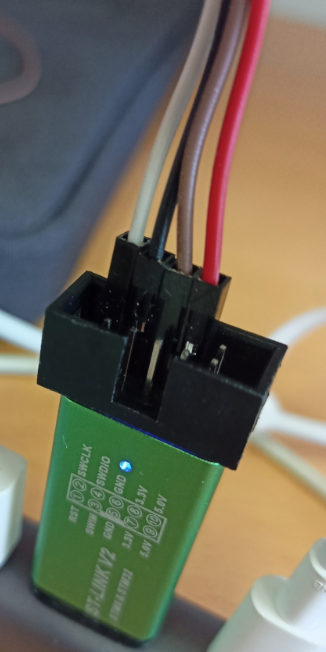

This programmer should be enough for SWV trace? I can't find some more info about it :p0693W00000Y6s1GQAR.jpg
AScha.3
if you can solder a thin wire - just mod your old stlinkV2 :
https://lujji.github.io/blog/stlink-clone-trace/

EBurk.1
Yes, I will do it. But I need "plan b" if it wont work as well. As I understand in ST-Link as shown upper have SWO and JNRST pins, right? And I can use it for SWV Data Trace...
how we can connect PB3/SWO pin.
