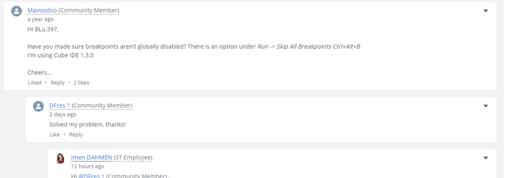

Hi BLu.397,
Have you made sure breakpoints aren't globally disabled? There is an option under Run -> Skip All Breakpoints Ctrl+Alt+B
I'm using Cube IDE 1.3.0
Cheers...

‎2021-03-16 1:48 AM
Solved my problem, thanks!

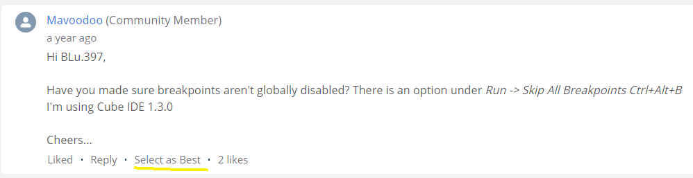

There is a "Select as Best" button at the bottom of the Mavoodoo's answer as you see in this screenshot :
Imen
