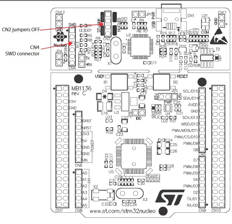

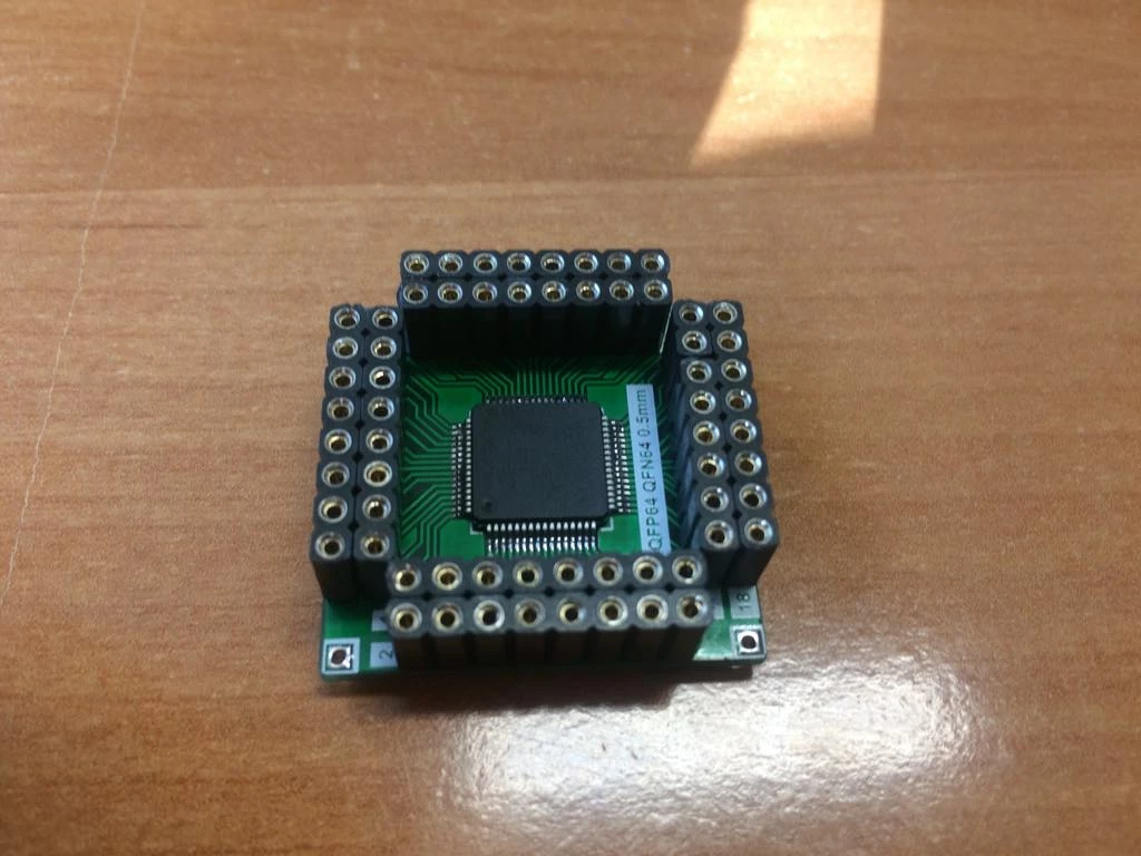

I have a microcontroller (STMF103RET) mounted to the adapter.
I would like to program it using the ST-Linkv2 programmer from the Nucleo board (STM32F103RB).
According to the instructions, I disconnected the CN2 jumpers and connect SWD pins to adapter.  After checking, I saw that there is no voltage on the VDD_TARGET pin.

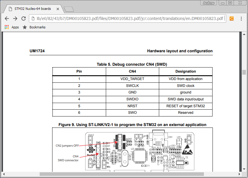

Table 5 - immediately above that picture you posted - describes the pins in CN4:
http://www.st.com/content/ccc/resource/technical/document/user_manual/98/2e/fa/4b/e0/82/43/b7/DM00105823.pdf/files/DM00105823.pdf/jcr:content/translations/en.DM00105823.pdf
Note that VDD_TARGET comes from the application; ie, from your target board - it is not a supply to the target!
