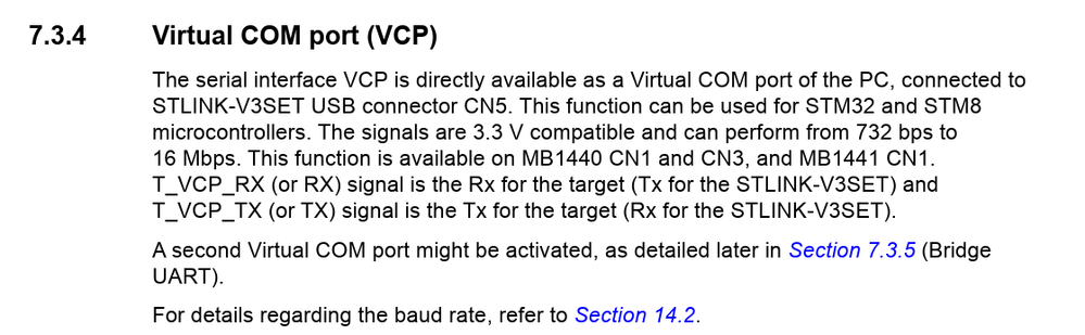

On the STDC connector, Pin 13/14 are virtual com port signals T_VCP_RX and _TX.
Which one is input and output? They have cryptic comments like "Output for STLINK-V3SET" (for _RX) - Is RX an output and connects to the RX pin on the STM32? Or is it an input and connects to a STM32 TX output?

My recollection is the "TX" on the V3 (MB1440B) side is the input, from the Target Board's USARTx_TX pin of choice.

It's not you, the documentation is not helpful. Would help if it said T_VCP_TX (INBOUND) or something similar every time it is mentioned.

This is in the User Manual of ST-Link V3 Set. This should be clear.
